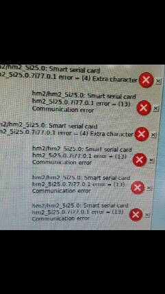

I have an mesa 6i25 + 7i76 and 5i25 + 7i77 ... on JA9 on lcnc2.8?? is possible??
Anywho some time ago I've some communication error at shutdown .... sometime during test operation ... I have some solenoid, big relais in cabinet and some electrical brake on motors ... so every one is connect to CNR07D470K as anti-spike device (38V max 11ns time of intervention) but the error continues to occur at shutdown, not always ... but before putting protective equipment was the same.
The 5V only power the mesa cards 7i76 and 7i77 ....
the image of error is these:
Some ideas??
regards
Giorgio

What kind of communication error? What does the alarm message say? Any other debuging information?
Never mind spoke too soon.
Have you loaded the latest firmware for your mesa cards? There have been updates to address these issues. You may also need to update to a newer Linuxcnc version.

As Todd says, make sure you update the 5I25/6I25 firmware to the latest and also update LinuxCNC to the latest version
This error means that there is sufficient electrical noise generated in the parallel cable (either by nearby noisy cables or a ground loop) to generate about a 2V spike in the FPGA input.
There have been two fixes done to improve noise immunity from random noise spikes. One is software changes in
LinuxCNC (I think these were done between 2.7.4 and 2.7.5, not sure when or if they were merged with master)
The other change is a firmware change (a digital filter on the FPGA receive UART RX pin) to reject RX pin noise lasting less than 1/2 of a bit time.
EDIT: The sserial issues in master were fixed around May of this year, so updating your linuxCNC
installation should fix the sserial error ( its not a bad idea to update the firmware also )
