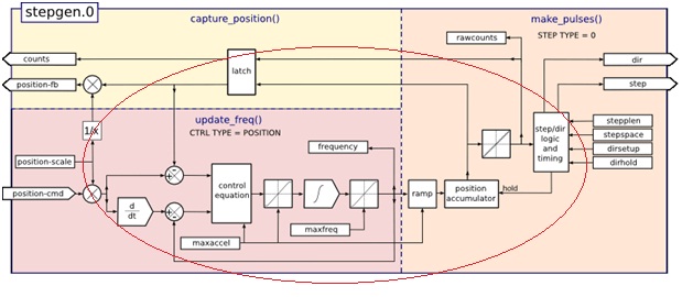

Need some explanation about stepgen

Replied by andypugh on topic Need some explanation about stepgen
You probably don't need ti understand the block diagram to make it work for you.
Fundamtentally, every 1mS you give the stepgen a new position command and it makes as many pulses as necessary to get there in the allotted time.
(You can use it other ways, if you want, but that is the way it normally works)
