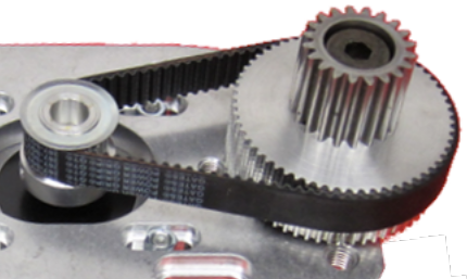

Please correct me! My logic is the rack (20 pitch 20 degree pressure angle) has 20 teeth on a one inch pinion.
Were it 1 to 1 then 200 full steps would move it 3.1416 inches (63.66 steps per inch). Introducing a reduction gear makes the stepper require more steps to travel that same 3.1416 inches. What was 200 steps at the stepper is now 600 at the rack on a one to three reduction. So 600 steps equals 3.1416 inches or 190.985 steps per inch. If your drive has a 10X microstepping then you are at 1909.854 micro steps per inch.

No, that is correct. a 20-tooth 20DP gear is pi inches per rev.
