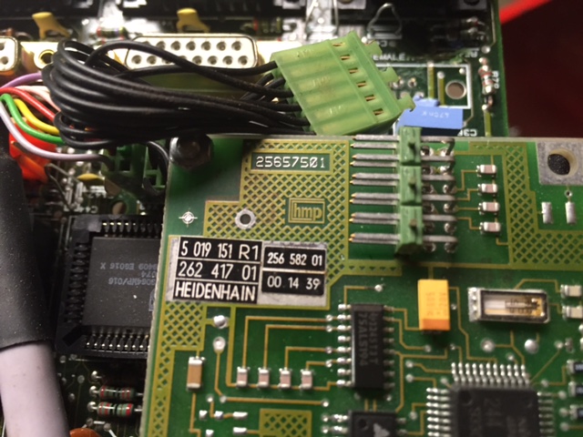

17 Feb 2017 10:26 #88121
by Mtndrew77
Replied by Mtndrew77 on topic Threading with A B phase only?
1. I attached a picture of the board you are looking for it's located underneath the old control screen. It sits on top of the Cpu board.
This is the board that converts from sine to square wave. I don't currently use mine because it is not really needed with my stepper motors, and the 7i76 only has a spindle encoder interface. LinuxCNC does not support a closed loop stepper system that I know of
2. LinuxCNC and the Mesa Card replace all the old electronics on my machine. I'm still using the old power supply, and some relays
and switches, but that is about it. I'm sure you could still salvage the old VFD and Step motor driver, but for my time and money it was way quicker and easier to replace.
Hope that Helps
