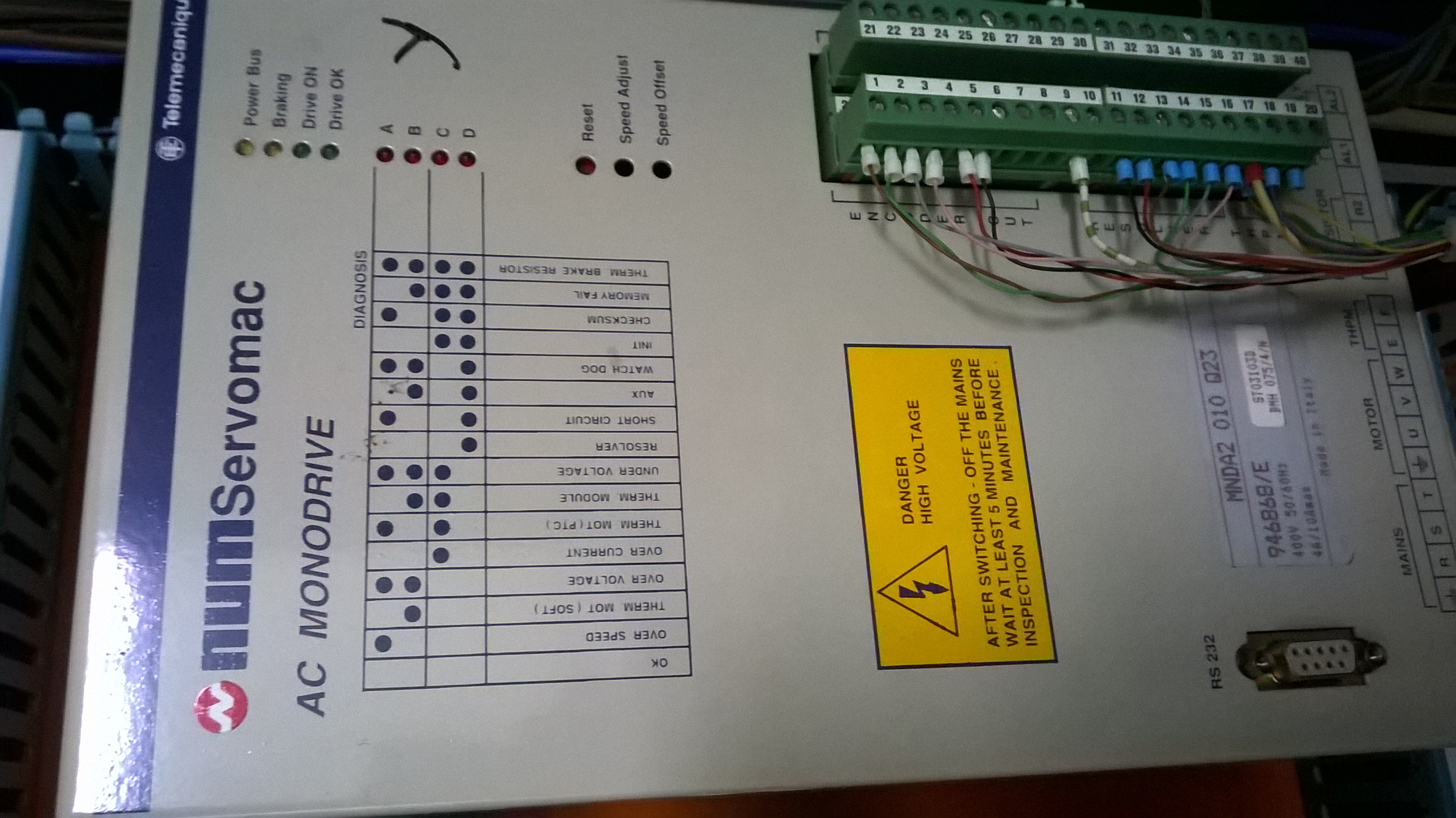

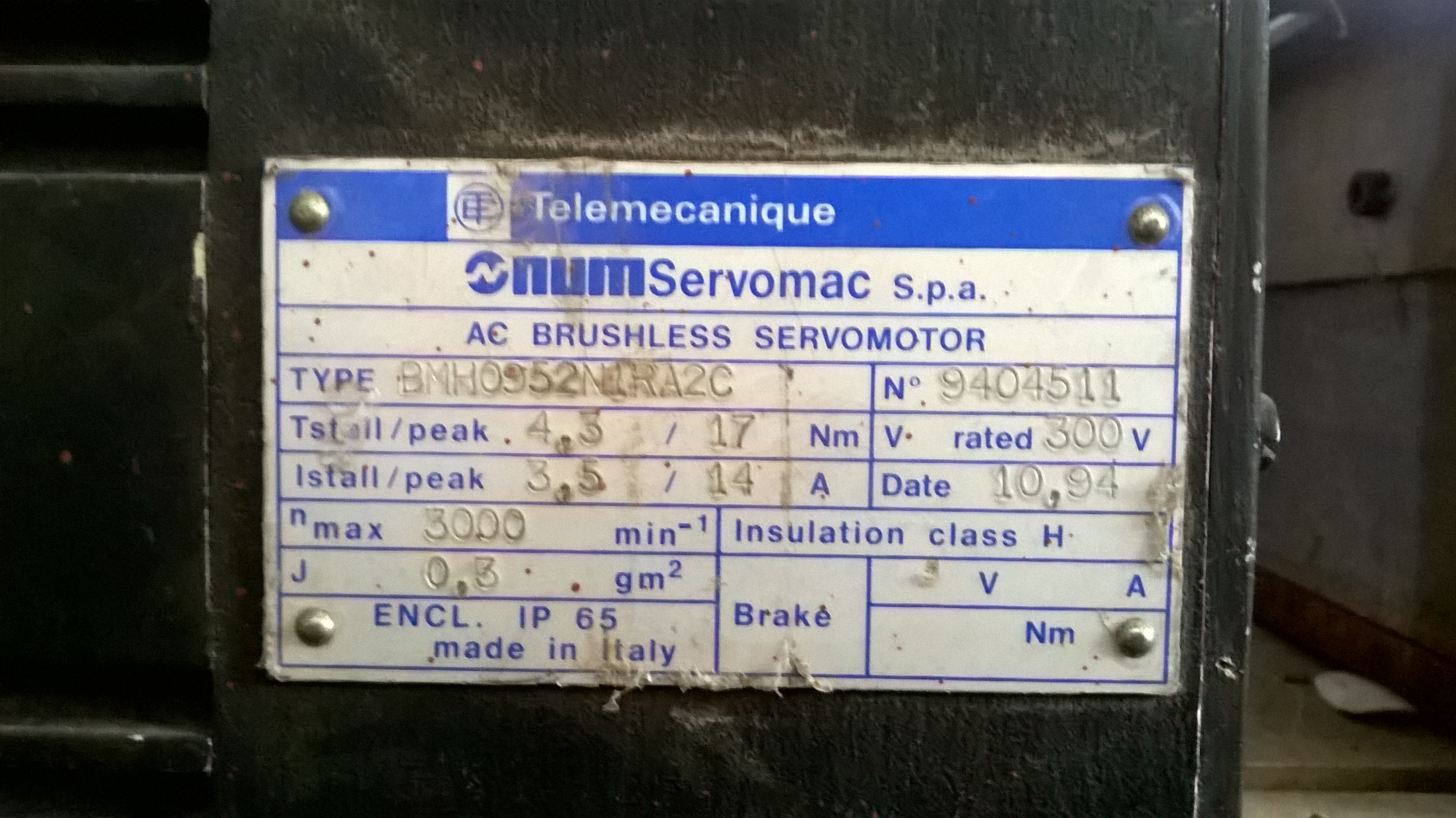

Hello everyone!
I m new to linuxcnc, learning for a project. I m trying to drive 3-phase AC brushless servos made by NUM using their own drives. Can someone help me determine if these drives can be used with linuxcnc? Some advice on how to do it would be much appreciated too!
I attach pics of the motor specs and the drive. If any more info is needed please ask!
Thanks in advance!
Thanks in advance!

The photos don't help me much. If the drives take +-10v analog input and has encoder output is is pretty simple. Other control methods are possible. Do you have the manual for the drive? Do you have encoders on the axes?

I see the word "Resolver" in the fault LED key, and I see "Encoder Out" on the terminal blocks.
So, the drive takes resolver feedback from the motor for commutation and position feedback, and then outputs encoder pulses for use by the controller.
It isn't obvious from the pictures what the control mode of the drives is, but I would be very surprised if they are anything other than +/-10V velocity-mode drives, and if so they should be very easy indeed to control with LinuxCNC. You will, however, need some add-on hardware, you can't really do +/-10V servo control with just a parallel port.

I went through the manual and it indeed uses a +/- 10V velocity reference.
