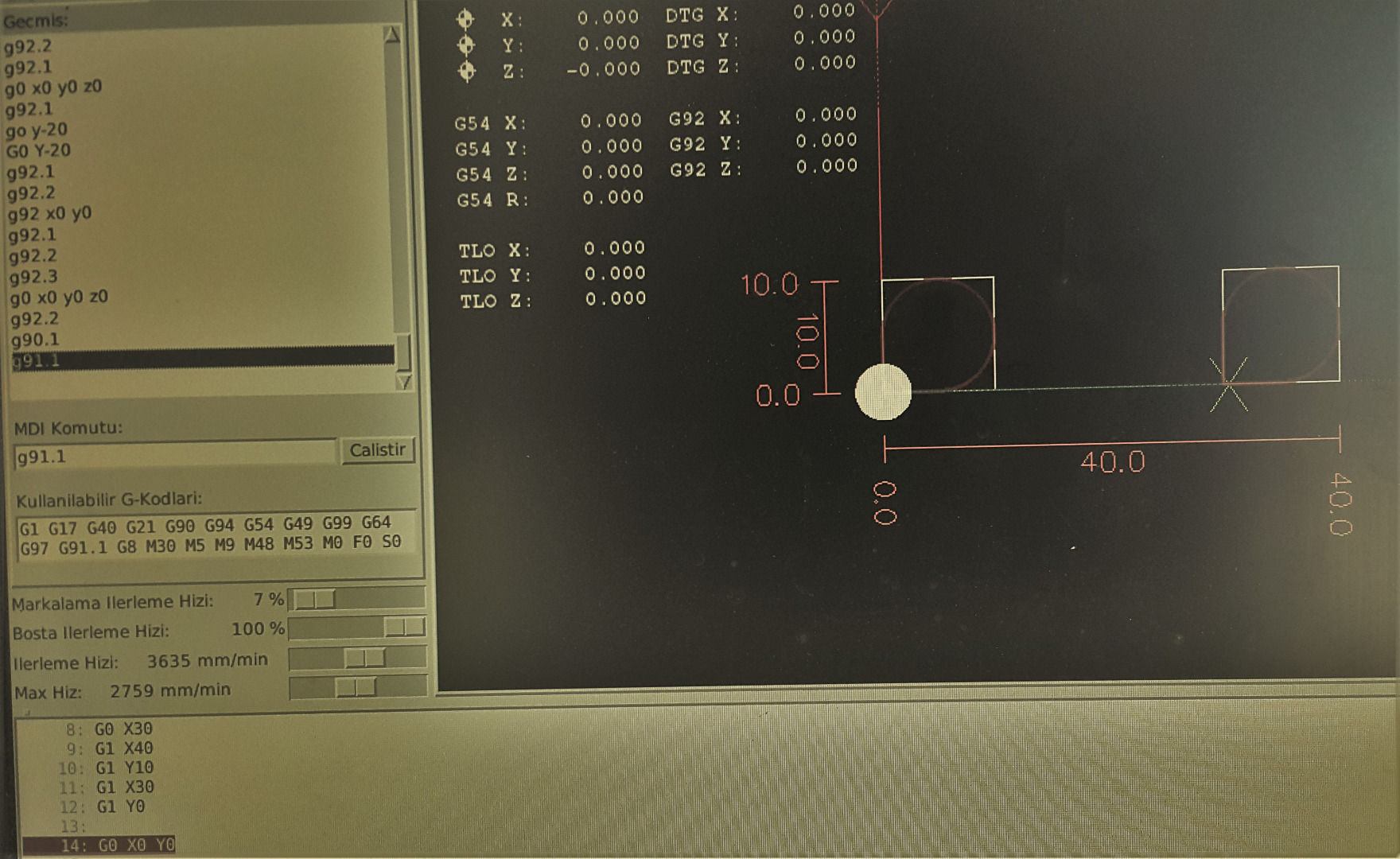

Hello to all,
I have written a sample G-code that was expected to run for a square. But the output was not the exact square, the corners was rounded.
As like in the screenshot...
s15.postimg.org/lu6rw5mbv/20161021_100515.jpg
And I dont know what was the problem....
Can anybody help me ?

The last comment was wrong. Your problem is that you are running your file in G64 mode with no precision tolerance. In that setting Linuxcnc will round the corners however much is necessary to maintain the programed velocity (while still touching at least once every programed path).
linuxcnc.org/docs/2.6/html/gcode/gcode.html#sec:G64
You need to specify G64 P0.005 or something similar. The P0.005 sets the path tolerance, such that the deviation from the programed path will be less than Pxxx. Or if you don't mind the program stopping at every corner use G61 exact path mode.

You need to add G64 P0.XXX where the XXX is the tolerance of how much the path can deviate from the original path.
Also check the accelerations as that will cause corners to get cut short. Set the acceleration to the maximum your machine can handle without loosing steps, and then lover that value by at least 30% so it has a bit of overhead.

Thats what I need bro. Thanks...
