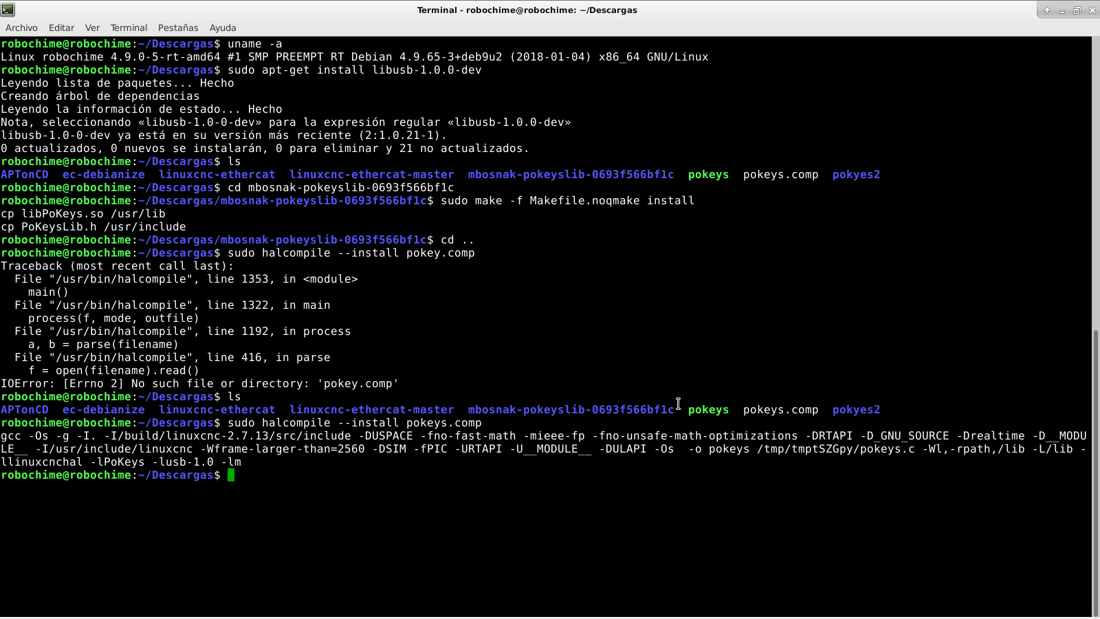

I have a problem that I could not solve myself, if you can help me, I think everything is installed, when I start linuxcnc I have the following error "pokeys: dlopen: /usr/lib/linuxcnc/modules/pokeys.so: can not open shared object file: no such file or directory ", I need to suppose that file, where can I find it? or what should I do? =, thanks Chimeno

Did you install the Pokeys library using the 'make -f Makefile.noqmake install' command?
(bitbucket.org/mbosnak/pokeyslib)
If yes, try 'sudo ldconfig'

The command "sudo ldconfig" has not made any effect, I have the same error, where is it or where can I get it "pokeys.so", it is not in the / usr / lib / linuxcnc / modules directory, you have some more idea than I can try?
resolved
I had a problem that loaded the mudulo in "loadrt" instead of "loadusr", now to see if I can communicate.
thanks Chimeno

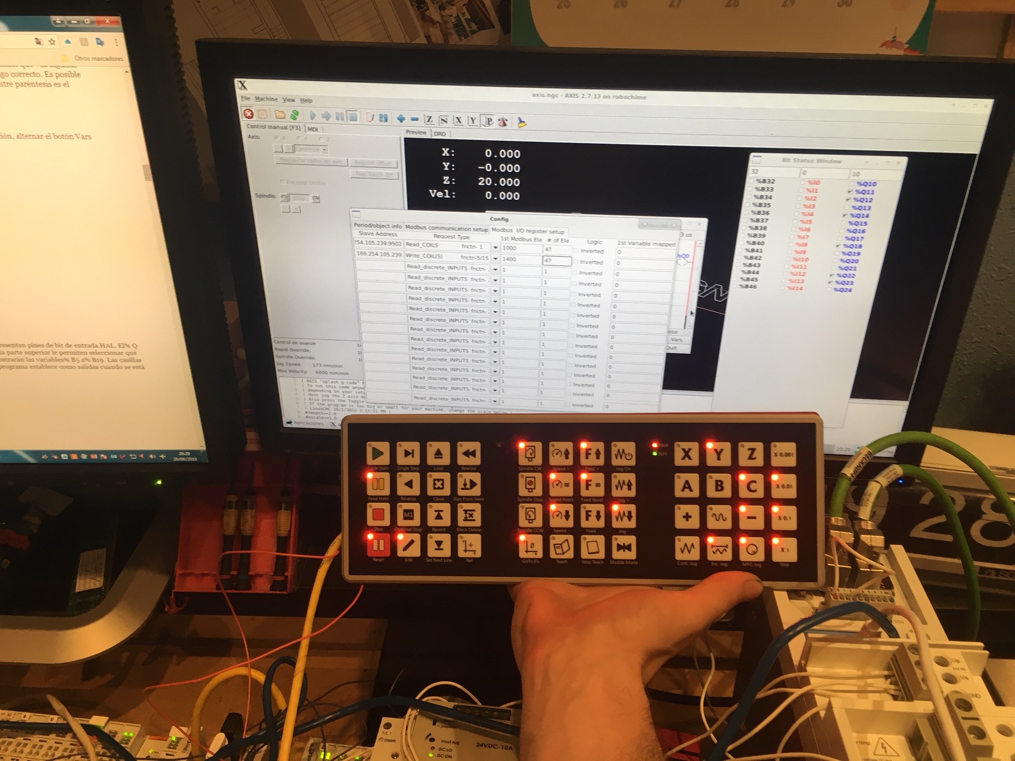

I am trying to use Pokey57E with the PoNET Bus through the library "PokeysLib.h" to create a driver and to use the Kbd48cnc keyboard, I attach the file that passed me Matevž de polabs of the transmission protocol, not if someone is interested and can help me in the process, thanks to everyone, every day linuxcnc is bigger!
Chimeno

at the moment I have the keyboard worked through modbus and classicladder, it is the second time I integrate it and the truth is quite good, when I have a little more time I would like to create a specific component
regards
Chimeno
