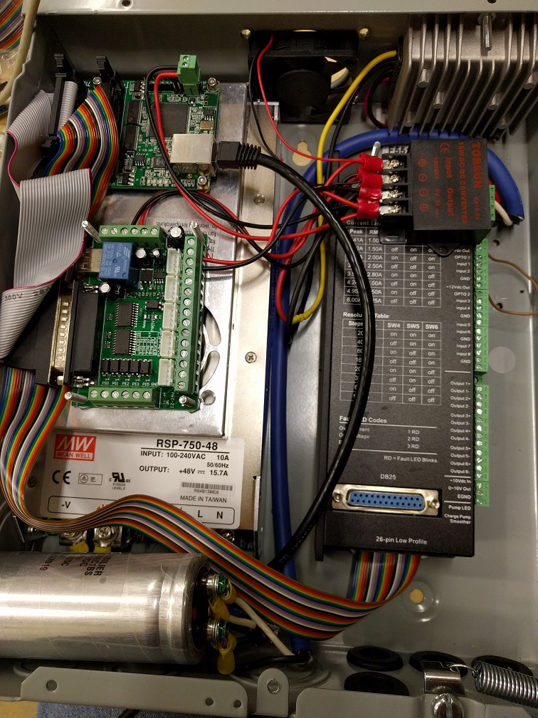

I am brand new to LinuxCNC, so please bare with me. I have been CNC'ing for about 15+ years moving from Mach3+SmoothStepper over to LinuxCNC + 7i92. I am stumped. I think I am missing some of the basics.
After a lot of problems and driver issues, I think I have a stale Linux setup of Debian Jessie x86_64 with a 4.4.27-rt kernel. I have LinuxCNC-uspace 2.7.7.53. My 7i92 is up an functioning, I think. I can ping it and linuxcnc is talking to it with the hm2_eth mod. My CNC is a RoverCNC router (Dual X axis setup). I am running a MX4660 controller attached to port 1 and have a cheap break out board attached to the other port.
I loaded the "7i92_MX4660x2D.bit" using mesaflash, I think.
How do I assign my pins and ports?

30 Oct 2016 01:23 #82247 by andypugh
Replied by andypugh on topic 7i92 setup help
Firstly please accept my apologies for the delay. I have had this in my in-box to reply to, and hadn't noticed that it wasn't approved and that only the moderators could see it.
Hopefully now that the post is actually on the forum there will be rather more activity.
To address your main question, the pinout is largely governed by the firmware. Basically each pin on the 7i92 can either have the function the firmware file gives it, or can be GPIO if that function is disabled.

31 Oct 2016 03:15 #82268 by dingbatca
Replied by dingbatca on topic 7i92 setup help
PCW: Dont think I have much choice. The HM2_ETH driver only works in Preempt-RT. Please correct me if I am wrong.
Next dumb question. English/Metric units causing me problems. When I move my CNC 1in in LinuxCNC it actually/physically moves 3.94in (10cm). I have "LINEAR_UNITS = inch". Ideas?
P.S. Thank you everyone for the wonderful and in depth help.

31 Oct 2016 03:28 #82269 by tommylight
Replied by tommylight on topic 7i92 setup help
What scale do you have in hal? That is for sure the wrong scaling, although your calculations are correct, but only if you have the motors directly coupled to the screws.
So check the actual screw (probably OK) and the micro stepping as it is close to 4 times the needed distance, so you might have the drives at 1/2 micro stepping.

31 Oct 2016 19:22 #82280 by dingbatca
Oh I get total N00B points today. I have the MX4660 mounted vertically. SW1 is at the bottom, not top. DOH! Ya, it was 1/4 micro stepper. Fixed and it is now moving correctly and I can hold 533IPM! Woot!
