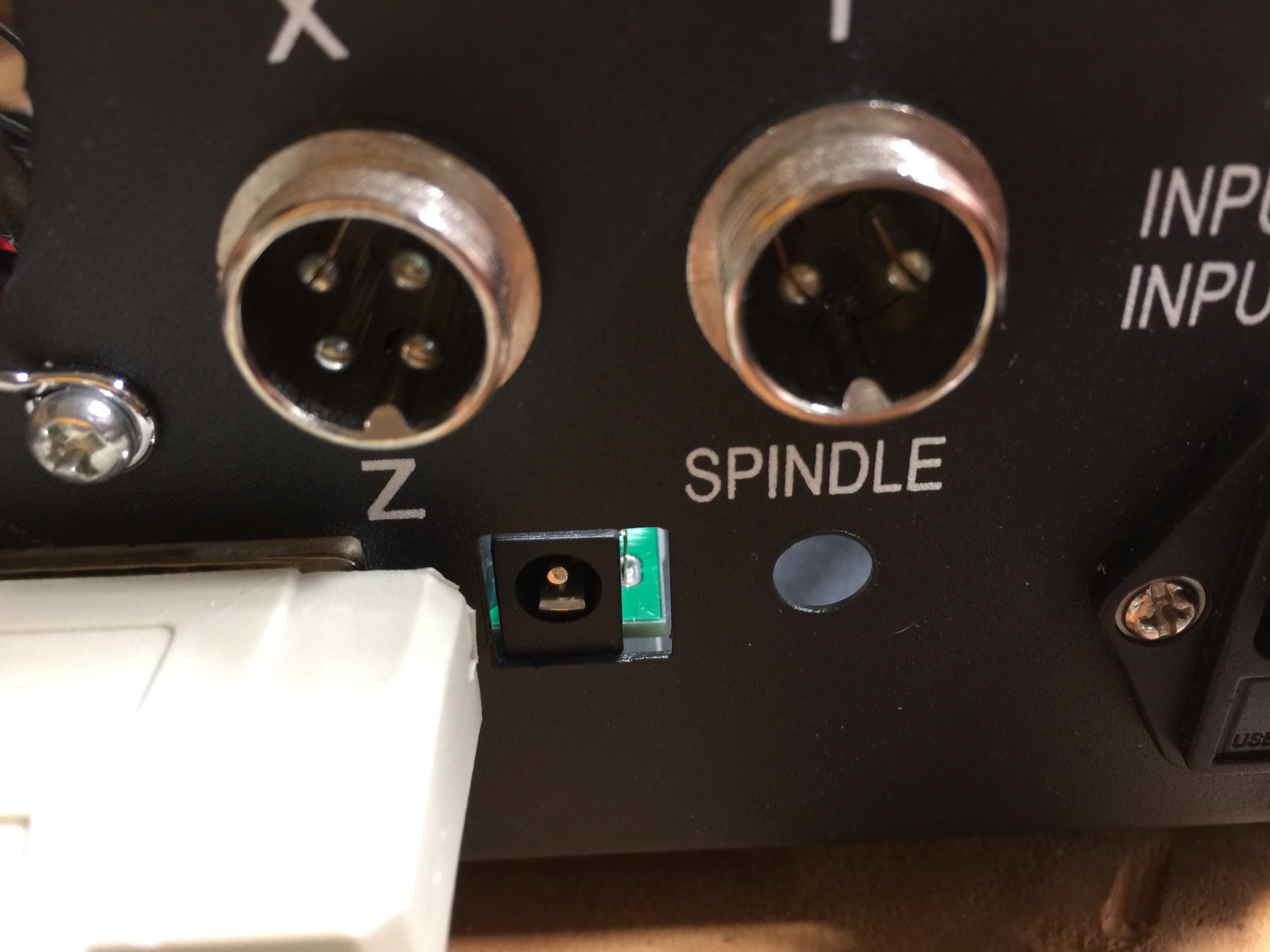

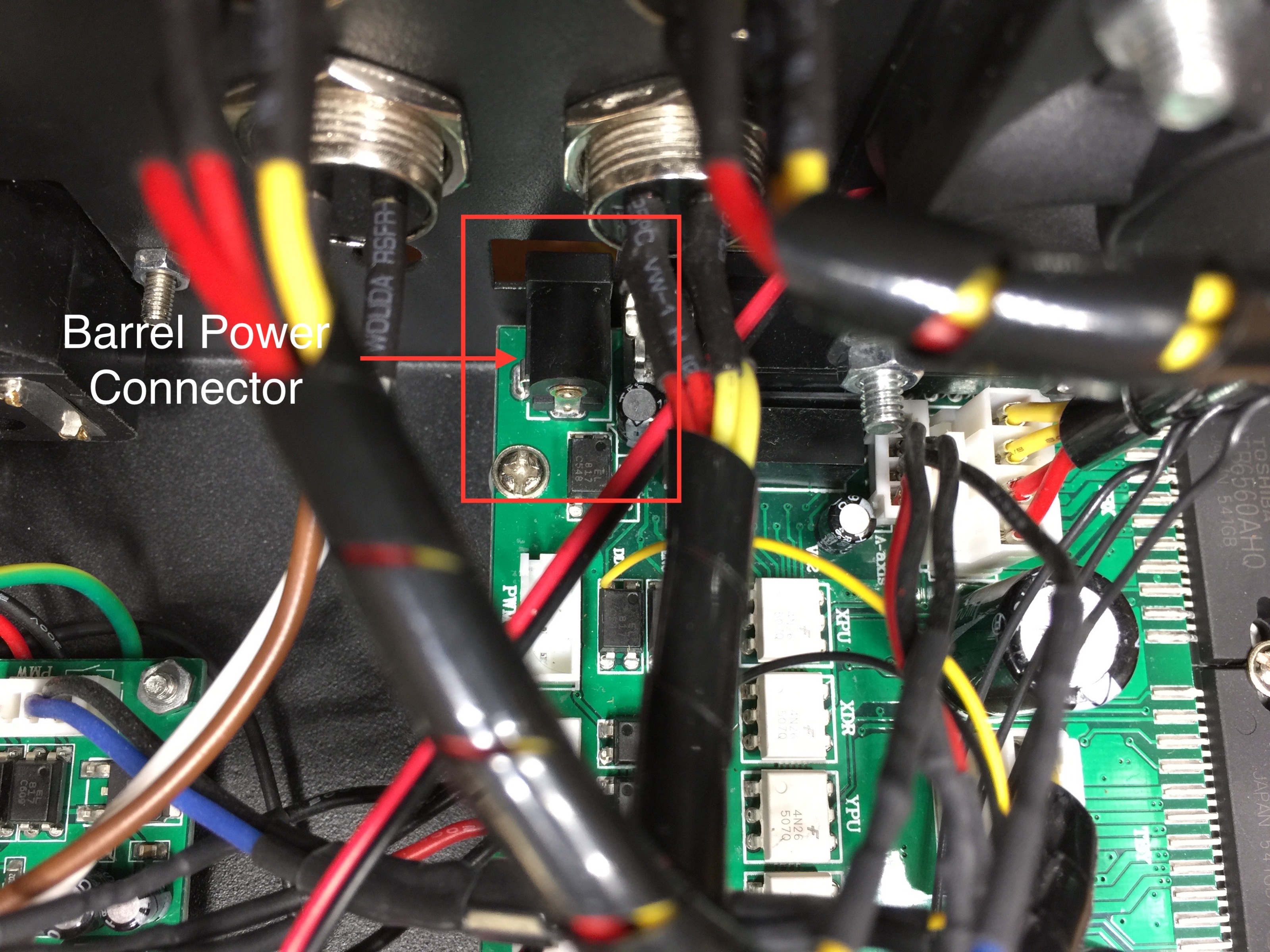

I have a 3020T hobby CNC and looking to use autoleveler.
So I'm trying to set up the probe touch off on the controller. I have opened the controller and looked at the pcb, it's using the JP-382A PCB. Has anyone added the input for the Probe to this controller.
Has anyone get any pictures or steps I can copy?

My 3040 control box has a barrel connector installed and connected. It is indicated in the pic I'm attaching.
Wiring it is simple, I used a micro-switch for testing purposes.
In my .hal file I added this to connect the probe input and invert it;
net probe-in <= parport.0.pin-15-in-not
Then added this to allow the G-code to recognize the probe "trigger";
net probe-in => motion.probe-input
Hope this helps.

I also have the DC connector aswell, didn't know what this was, so your telling me this is in pin15 for a Probe input?

Got it working. Thank you.
