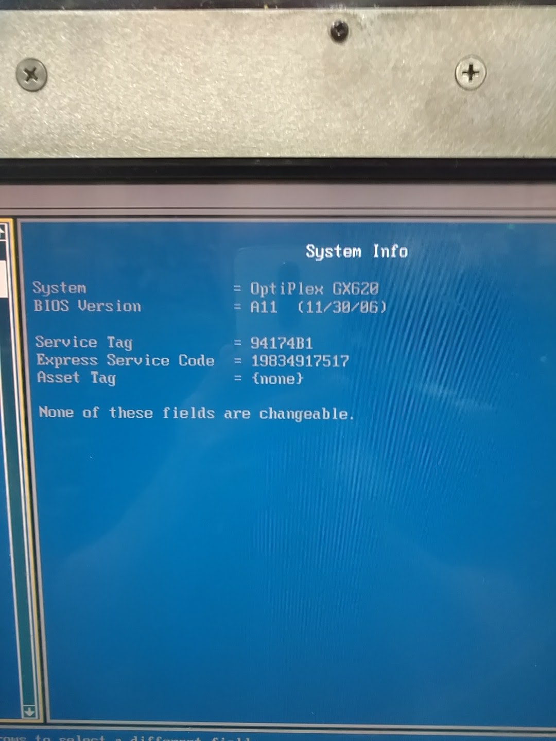

Everything is orginal except the hard drive. It is a Dell GX620 with a 25pin D-shell parrell port.
Replied by tjamscad on topic Error,
Just read the complete thread, and one of the errors mentions that existing parallel port does not support mode 4, so that just proves that you do not have a PPMC and the parallel port will not work as one. Do you have a PCI card on the old computer? If so, you will have to use that card and change the I/O address.
Ok just saw your post. So you do have one.
Now that is the external card. Is there a internal card on the old computer?

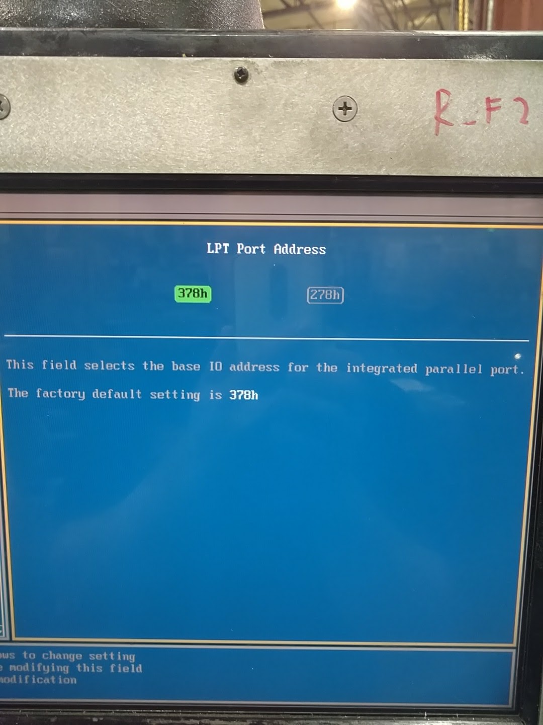

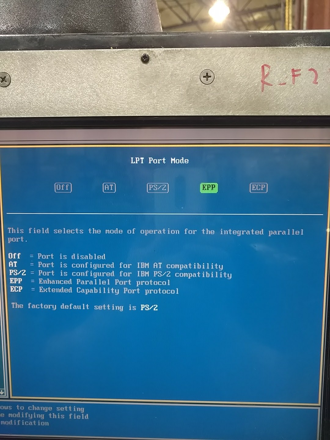

Bios settings

Everything looks O.K.
The only problem.you have to solve is to check permisions for hal_ppmc.ko as you are geting permision denied on that file. That file is located in the rtai kernel path so i assume it is a comp that has to be istalled ( with halcompile ) or it might work by changing the permisions of that file. Check to see if it is executable.
I rarely use halcompile, so i am not sure how to use it or of it is usable in this case. Check the config folder if you have a file with th .comp extension ( suposedly hal_ppmc.comp ) .
Also check '/usr/realtime-2.6.32-122-rtai/modules/linuxcnc/hal_ppmc.ko' for executable .
