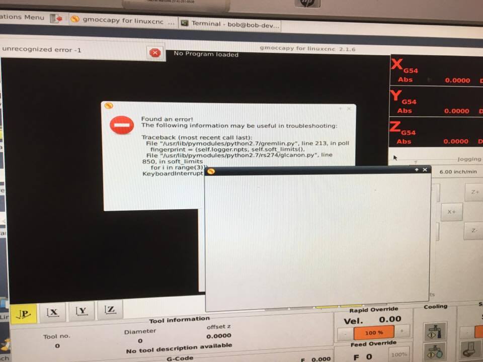

In Axis, when it is running and you change somethin in configs and want to restart, you can just start via shorcut on desktop. it wil ask you it is ruunning already, Do you want to restart Linuxcnc. If you say yes, it will shutdown and restart.

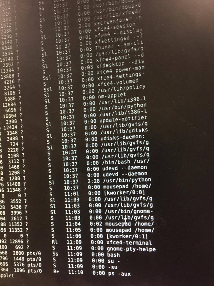

In Gmoccapy it throws errors everytime, and you cannot close the errors, plus I cannot find the pid it is running to kill it, so I have to restart.
Is it in the plans to fix this?

You should't say YES!
I just checked that.
I got a similar behavior:
I opened two terminals,
started one config from terminal 1
started the same config from the second terminal
got the message "still running, restart"
Said yes
I got error messages like your screenshot, and I was also not able to close them, but killing the first terminal solved the problem.
I have to chek if that can be avoided.
Check the terminal output! A lot of errors. But also the PID of the Process
Norbert

I found the solution, changing the linuxcnc start script. I also added some more testing to some other filed to avoid the errors you mentioned.
I just pushed 2.2.1, please test, if that suit your needs.
