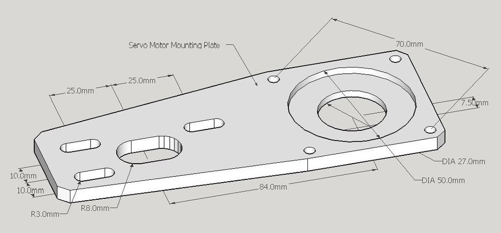

Does anyone have bridgeport motor mount drawings they can share? I see several company's like flashcut and microkintecs have there own kits.

see attached file, hope this helps!

That does help. Thanks!
