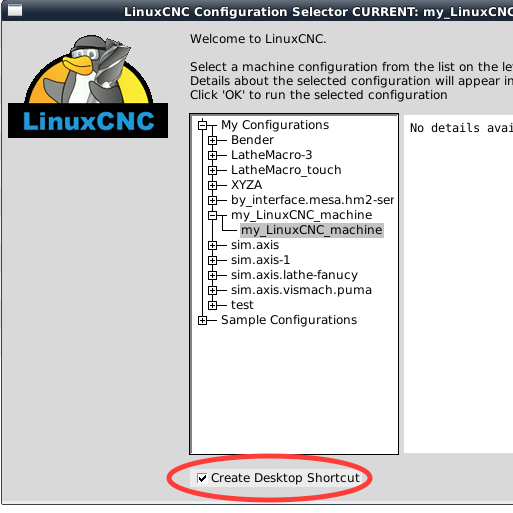

Replied by andypugh on topic Help Create a shortcut for configuration
You might be installing LinuxCNC in a much more complicated way than necessary. You can get it in the same way as any other application, or as a LiveCD install.
But, now you have got this far, you might as well continue.
The easiest way to get a launcher is to follow the instructions in the earlier section:
Then in the dialog box that pops up, select the "make desktop shortcut" option and select your new configuration:
$ . ../scripts/rip-environment
$ linuxcncThen in the dialog box that pops up, select the "make desktop shortcut" option and select your new configuration:

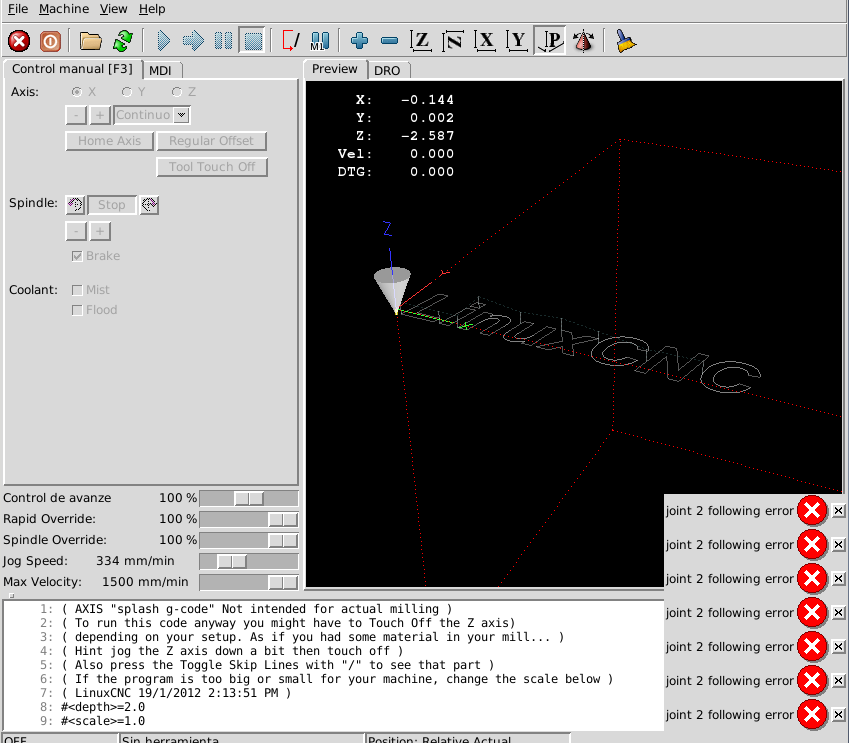

22 Jan 2017 19:50 #86416
by PABLOSAN2903
Replied by PABLOSAN2903 on topic Help Create a shortcut for configuration
Thank you is done, now it is another problem, when I make my configs with pncconf I think everything is fine but when I turn on the machine it sends a signal, Z axis moves and it appears following error: joint 2 following error, in 0 (X) in 1 (Y ) And 2 (Z), comparing several HAL files. Of other people to me it comes out different (I hope to upload the images because I do not know how) well part of the axes (X) (Y) (Z) I have there are a couple different things I hope they can help. And thank you for your help, the different parts are as follows:
setp pid.x.error-previous-target true (This never appears when everything is going well)
net x-vel-cmd => pid.x.command-deriv (Here I changed in other HAL files. Cmd per fb example: net x-vel-fb => pid.x.feedback-deriv)
God will reward you.

- Todd Zuercher
- Online
- Posts: 4786
- Thank you received: 1476
22 Jan 2017 20:15 - 22 Jan 2017 20:18 #86420
Replied by Todd Zuercher on topic Help Create a shortcut for configuration
Having a joint following error, is expected behavior until after you have the PID tuned for each axis.
Here is a link to a good tuning tutorial.
gnipsel.com/linuxcnc/tuning/servo.html
A couple of possible reasons for an immediate following error when turning on would be having the encoder direction or output scale backwards.
Last edit: 22 Jan 2017 20:18 by Todd Zuercher.
23 Jan 2017 00:10 #86448
It is very likely that the problem is that the Z-axis motor and the Z-axis encoder disagree about which direction is positive.
Try making the Z-axis encoder scale the same number but negative.
If that works, and the axis moves in the right direction, then you are good to go. If it moves the wrong way, put the encoder scale back, and change the pwm / analogout scale to reverse the motor instead.
