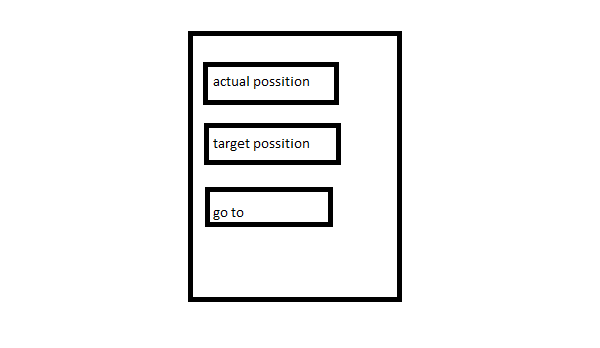

what i want to do is use stepconf to set up 1 axis as a fence on a chop saw,then the ui would need to have a numeric box to enter a target measurement (preferably by clicking on the box and entering the numbers on the keyboard) then a button to make the axis go to the target measurement.If possible it would also be good if the ui could show currentl position

Replied by andypugh on topic can you add a measurement field and a go to button to emc2
I don't think that stepconf would be able to help with this.
You might find this thread interesting, it is close to what you want (your needs are simpler). A table of positions might be more useful.
forum.linuxcnc.org/38-general-linuxcnc-q...ideas?start=10#82686
I can't offer to do this for money, I am on a skiing holiday all next week. And I don't ever take money for linuxCNC stuff because I want to keep it as a hobby. I might be able to put something together in a couple of weeks.
