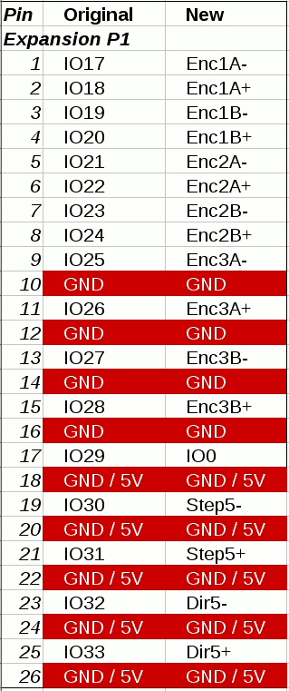

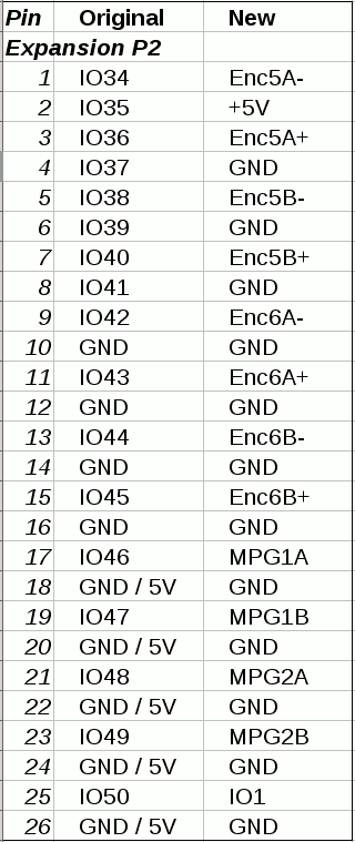

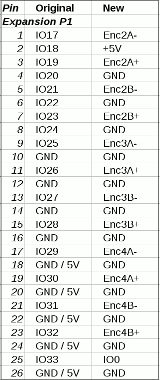

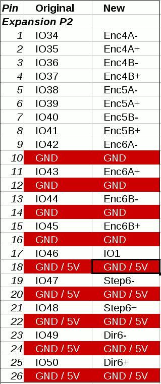

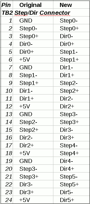

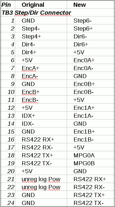

Hello,
after fiddling around a 7i80HD I'd like to go for a 7i76E - from the numbers of pins it should be fine, but the original pinout is too much wastage of pins. My stepper drivers have differential interface, so I don't need 5V and GND on the stepper channels. So I painted a new pinout.
Is it possible to achieve such a pinout with the 7i76E?
... and is there anybody willing to help me create a new bit-file?

You will have to wait for PCW to confirm, but i know for sure you can not change the +5V and GND pins on any board, Mesa or other.

You cannot use bare FPGA pins for differential inputs (except LVDS which will not work with encoders)
Differential signals from encoders are used as a way of rejecting common mode noise, Standard RS-422 receivers
can detect as little as 200 mV of differential signal in as much as +-7V of common mode noise. The FPGA inputs in differential mode have a much smaller common mode range. Also Note the 7V of common more noise will destroy the FPGA chip in microseconds. It might be conceivable to use LVDS inputs with balanced resistive divider for each encoder input but not sure whether that's worth the effort.
Also in general its not suggested to drive step drives directly with the FPGA outputs. This can work if the FPGA is driving step drives with optocouplers with a common 5V (common Anode) connection and the FPGA is sinking current,
but is unlikely to work well for differential outputs since the outputs will not source current above 3.3V
If you want additional step/dir outputs and differential encoder inputs I would suggest adding 1 or 2 7I85S daughtercards
