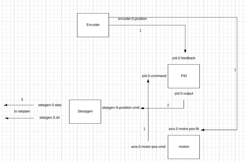

hi,
i'm trying to config HAL file for linear encoder-with one wire puls. and creat a closed loop on the steeper baset on posion.
(stepper ruing with geackoG540).
i tried to understand how to integreat HAL components -motion, encoder, stepgen and pid
i put it on diagram. is that how the componets realy conected??
forum.linuxcnc.org/media/kunena/attachme...atHAL_2017-02-20.JPG

- Todd Zuercher
- Posts: 4772
- Thank you received: 1467
20 Feb 2017 20:35 - 20 Feb 2017 20:37 #88386
Replied by Todd Zuercher on topic HAL config for linear encoder and stepper motor
No guarantees this will work as advertised (step motors are not servos and won't step faster when stalled).
But it is Motion sends position cmd to PID, PID sends velocity cmd to Stepgenerator, Stepgenerator sends pulses to motor drive.
Encoder sends feed position back to PID and Motion

- Todd Zuercher
- Posts: 4772
20 Feb 2017 21:54 #88400
Close, the stepgen pin will be "stepgen.N.velocity-cmd" instead of position-cmd. But the basic gist of it is right.
Don't forget that the stepgenerator type needs to be set to velocity as well.
Pin names etc. will be different for a hardware step-gen.

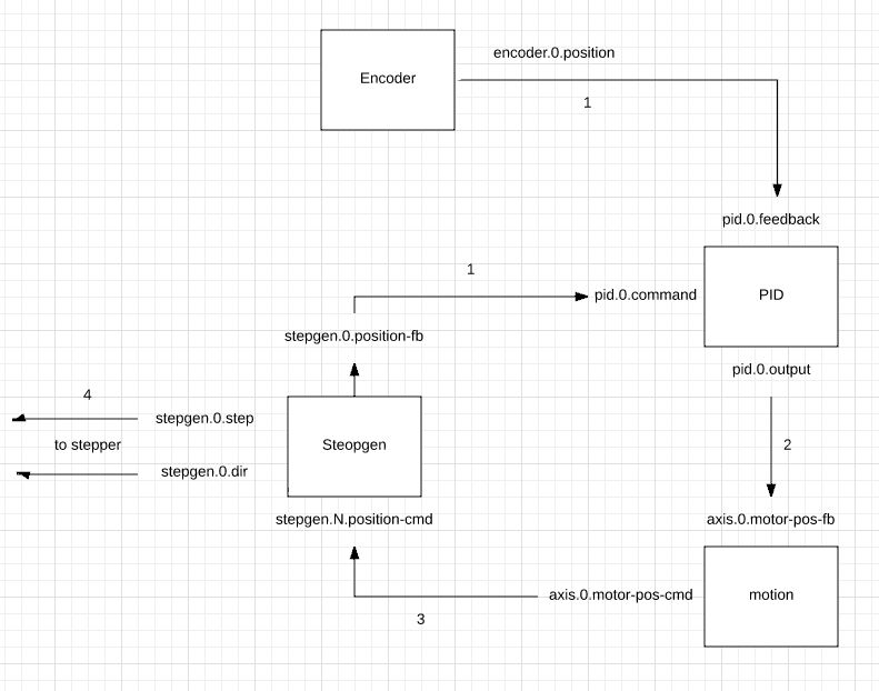

Thanks for pointing it out.
some how i missed the pid output is in vel units.
does step type 2 will work on steper motor? (there is no step and dir only phaze A and B . correct? )

- mgadid
- Posts: 8
21 Feb 2017 21:20 - 21 Feb 2017 21:23 #88464
by mgadid
Replied by mgadid on topic HAL config for linear encoder and stepper motor
Last edit: 21 Feb 2017 21:23 by mgadid.
PID and encoder settings can be set up only in hal. But they are usually set up in the ini, with the hal files using variables to reference the ini.

so the next step is to fireup Linuxcnc and try the file?
