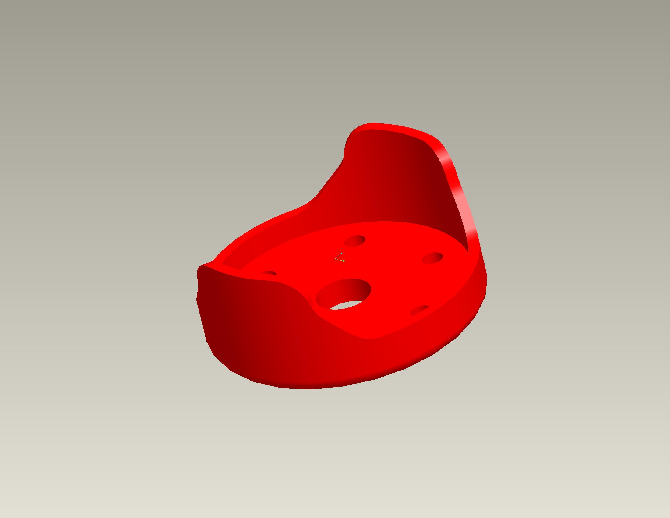

I am trying to machine a part that looks like a cup with varying heights of the side wall around the cup. the part is held on my fourth axis and the program basically varies x as the part rotates on the A axis. The problem I am having is getting a consistent feedrate in the cut. For G1 commands where X is constant and only A is changing, I need a feedrate of F130 because the feedrate is needed in degrees per min, but for G1 commands where X is changing, linuscnc wants the feedrate in inches per minute. I can get most of these changes done, but I run into problems when both X and A are changing. It appears that when X changes, the ipm rate takes over, but if the change is a small X increment over a large A degree change, the A axis feedrate goes way up and the overall linear rate of the tool movement on the part is high and I am snapping tools. I need to be able to get a constant surface feed rate whether the G1 command is changing X or A. Remember this is on a mill's fourth axis. Any suggestions?
I have computed the delta-X (the axis distance moved) and the delta-S (the circumferential distance moved) for each G1 command and I think I can use this information to compute a different feedrate for each G1 command, but I am not sure exactly where I am going with this. Has anyone ever run into this problem?

I believe that my linear and rotary setting are good. I can easily machine any 3D part and specify the feed rate in inches per minute. I have also machined circumferential slots in a tube and for those cases I specified the feedrate in degrees per minute.
My current problem arises when I want to move both in the X and the A directions, such as for when you would machine a spiral around the circumference of a rod. Actually I think I could figure out how to machine a spiral since it would essentially have a constant lead angle and I could simply determine the feed rate by running the program without a tool and then just eyeball the feed rate.
Unfortunately my problem is more complex since my profile is not a simple spiral. I have attached a jgp of the part. The blank has been turned on the lathe and currently looks like a simple cup. Now I want to rotate and mill it on the fourth axis in order to create the shape of the two flanges on the circumference. My problem arises because the "lead" ( the change in x relative to the change in A) varies and thus even a slow constant feedrate results in rapid accelerations in the tool movement relative to the surface of the part. This appears to happen when the cut is moving at f2 in the X direction, but the profile requires the part to do a rapid 30 degree rotation for just a little movement in the X direction. The resultant movement is a high surface velocity and that snaps the tool.
I am now looking at recomputing my profile using a constant 2 degree rotation for each G1 command and computing the associated X value for each 2 degree rotational step. Maybe this will stop the accelerations of the tool.

Thanks to everyone who provided assistance. I eventually solved the problem by using the G93 command. I computed a new tool path with each G1 command corresponding to 2 degrees of rotation of the A axis and then whatever corresponding X movement that was need to follow the part profile. For each G1 step I computed the total tool movement using Pythagorean's theorem and the distance traveled equaling the square root of the sum of the squares of the X distance and the circumferential distance (which was computed by the A angle in radians times the radius of the part). Knowing the total distance traveled for each G1 command, using the G93 command I computed an inverse time value (F) for each G1 command by taking my desired feedrate and dividing it by the distance traveled. Since my part was approximately 1.9 inches in diameter and since I chose to machine it at a slow rate of 2 ipm, I got inverse time values on the order of 60 for a straight 2 degree rotation of the A axis, down to an inverse time values of 22 when the G1 step included the 2 degree rotation and a significant movement in the X direction.
After re-assemblying my CAM program I was able to machine the part with basically a constant feed movement of the tool whether the toll was simply moving along the circumference of the part using only an A axis rotation, or whether the tool was moving both around the circumference and in the X direction in a spiral path around the part. Finding out about the G93 command was a real help.
