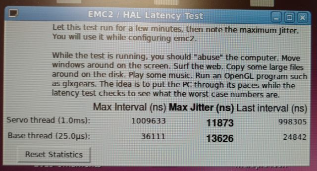

I have been getting an error "Unexpected real time delay" upon startup of Linuxcnc, forever. I have read about the Latency testing and have done it several times, but I never changed any parameters.
My Base Thread = 100000 in my .ini file.
I just ran the latency test and it (Base Thread) came back at 27540. Can anyone tell me what my Base Thread should be in the .ini file based on this latest test.

There has to be an answer to this. I just reran the latency test after playing with some video settings and the highest I saw the base thread go was around 14500 and most of the time it was below 10000 EXCEPT when I opened some picture files and then it would spike above 200,000. I believe that it must have something to do with the video card (which is Nvidea).
Thought maybe I had fixed something as the first time I opened Linuxcnc, I didn't get any error, so i shut it down and restarted Linuxcnc again and the error message came back.
This is a dual boot machine and I had to go back into Windows XP to change anything. I never use Windows and I am not connected to internet with this machine. Also when running a toolpath, I am not doing anything else with the PC.
I am definitely not good with Ubuntu and getting around in it, so if there is something I can check, please tell me how (exactly).
Thanks for your help

16 Mar 2017 16:48 #89754
Replied by PCW on topic Latency question
Did you see this?
wiki.linuxcnc.org/cgi-bin/wiki.pl?Troubl...d_ATI_graphics_cards
The Nvidia driver has known issues with latency

16 Mar 2017 17:00 - 16 Mar 2017 17:25 #89756
by beltramidave
Replied by beltramidave on topic Latency question
Last edit: 16 Mar 2017 17:25 by beltramidave. Reason: added latency pic
