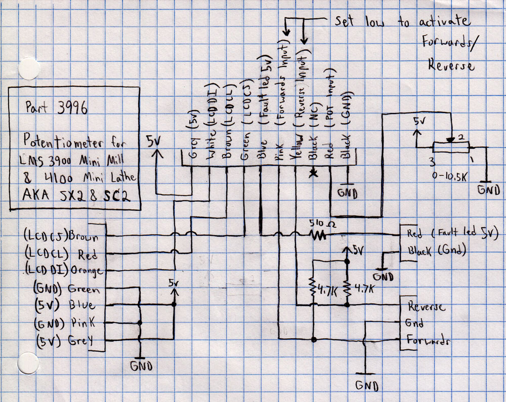

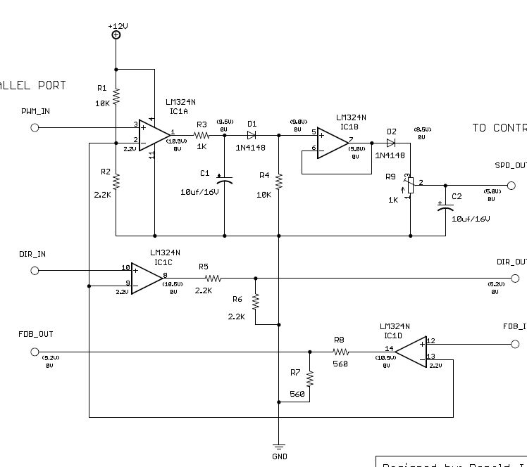

Right so that means that the input impedance cannot be 133 ohms
(or you would get ~0.25V at 1/2 scale rather than 2.5V)
I suspect you have a missing connection ( you are likely
depending on the previous PWM devices lack of isolation )

This is the connection diagram to the spindle control card.

This was the electronic circuit I used for the initial modification and it always worked.
