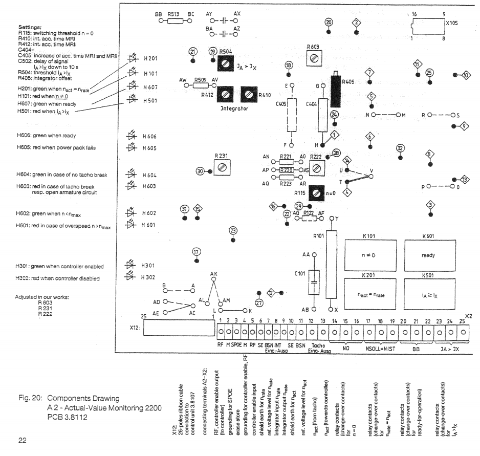

Yes, that of the RF. Disable led.
in my hal.file my spindle-on isn't connected. to witch pin should i connect it?
20 Mar 2017 15:30 #89951
Replied by andypugh on topic Spindle configuration
spindle-on in your HAL is created but not used. Just delete it.
It looks to be left over from a previous config or edit or something.
Your drive seems to have two separate enable inputs, Ready-for-operation and Controller-ready.
Try connecting one to the halui.machine.is-on HAL pin.

20 Mar 2017 19:03 #89961
No, I think you do need to connect extra cables, and one of the cables needs to be controlled from HAL by halui.machine.is-on (or any other pin that you want to use, like axis.0.amd-enable-out)
Can you give some tips or an example?
So i don't have to connect extra cables? I'm searching a long time on this and i'm totaly lost ;p
The following user(s) said Thank You: Nondepietjes

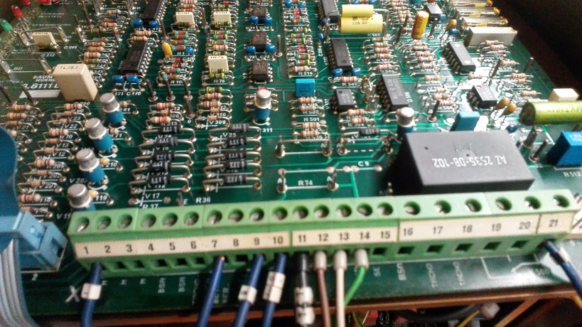

22 Mar 2017 08:25 #90048
by Nondepietjes
Replied by Nondepietjes on topic Spindle configuration
22 Mar 2017 09:29 #90051
The PCB has screen-printed legends on it, those are almost certain to be consistent with the description of the other panels in the documentation.
So, it should be possible to work out what each terminal is for from the screen-print and the manual.
