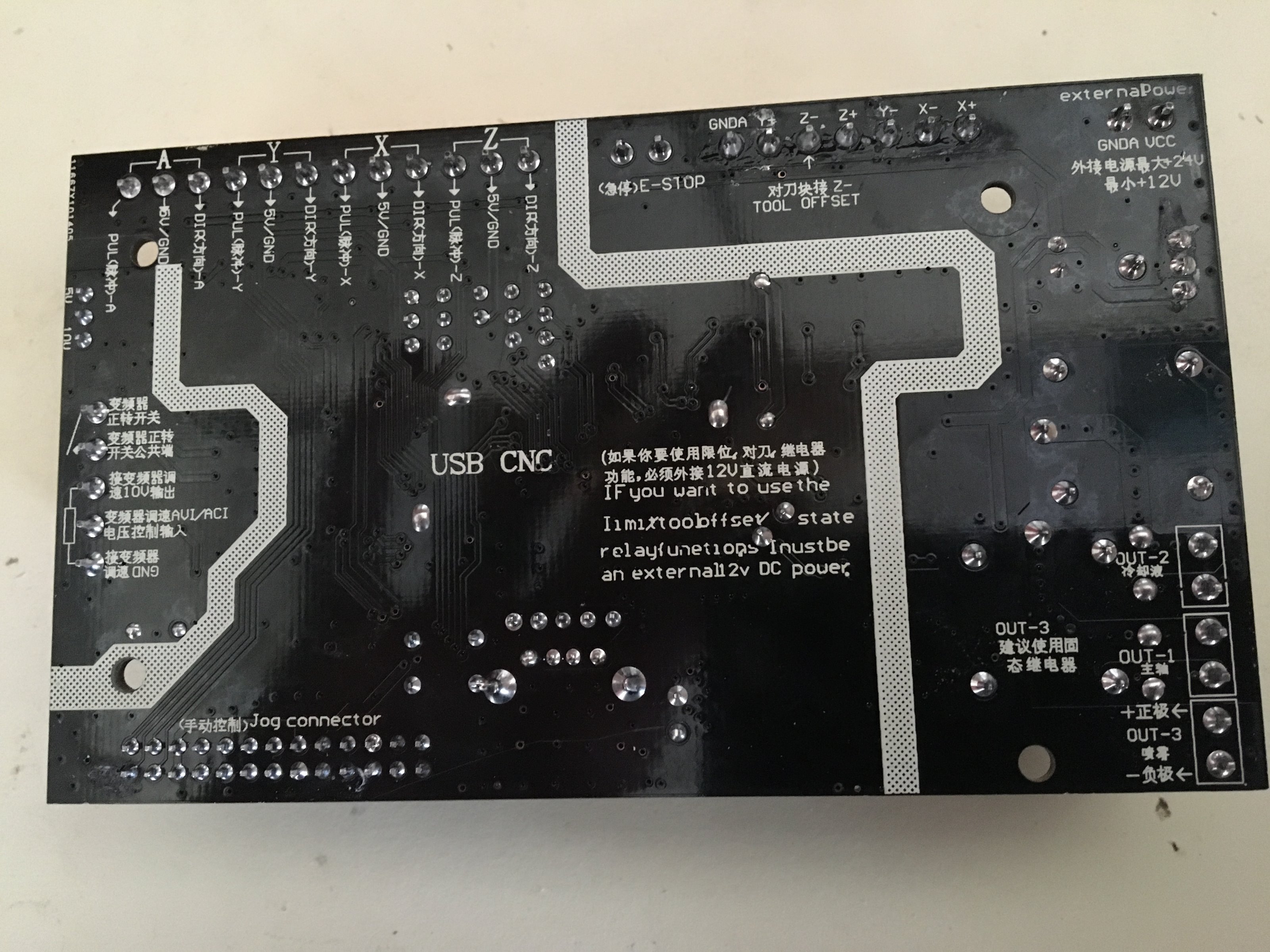

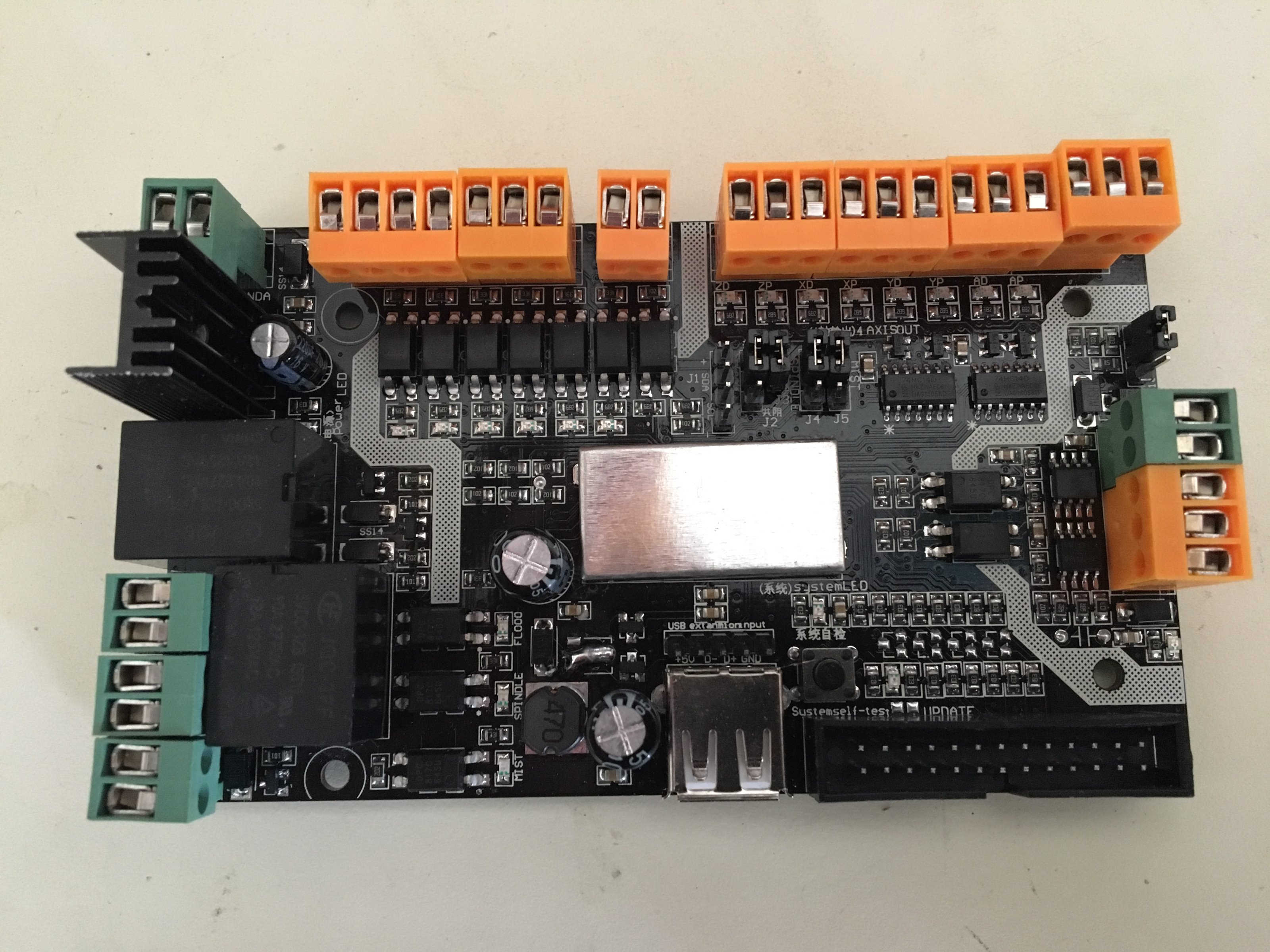

I am new to this and building my first CNC machine from scratch.
I am a little confused on wiring the drivers to the breakout board I have. It is a 4 Axis USB CNC Card Controller Interface Board for Mach3 DIY. So it says.
The BOB has the following points;
DIR
Z: 5V/GRND
PUL
DIR
X: 5V/GRND
PUL
DIR
Y: 5V/GRND
PUL
A: Assume not using since I only have 3 Axis unit (3 motors)
There is another location on the board for Z-Tool Off-Set, 7-points are Grnd, Y+, Z-, Z+, Y-, X-, X+.

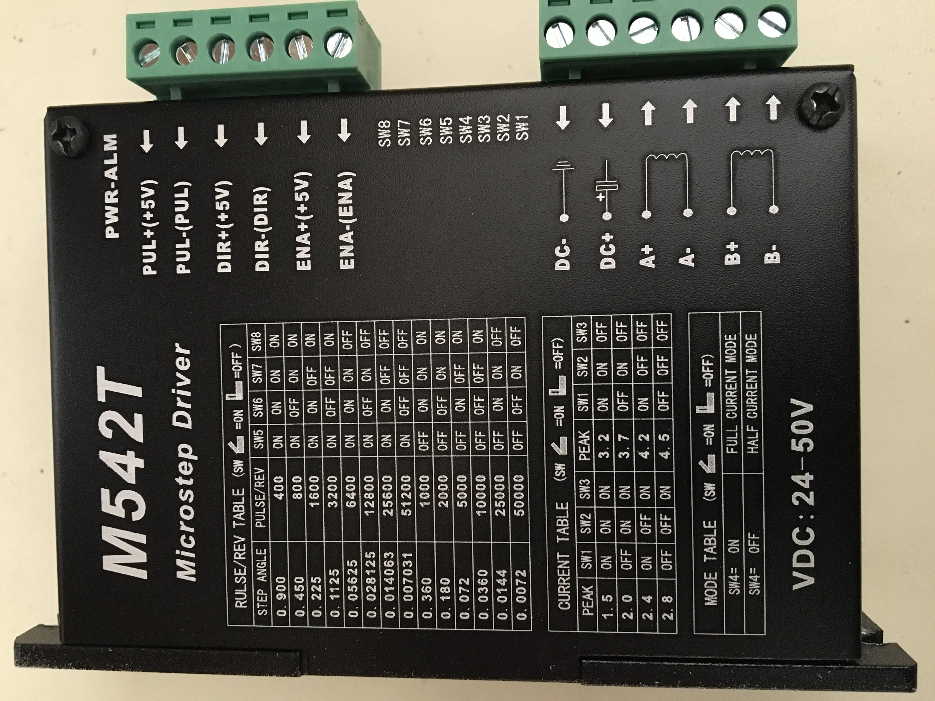

The M542T has the following points;
PUL+ (+5V)
PUL- (PUL)
DIR+ (+5V)
DIR- (DIR)
ENA+ (+5V)
ENA- (ENA)
What goes to what?

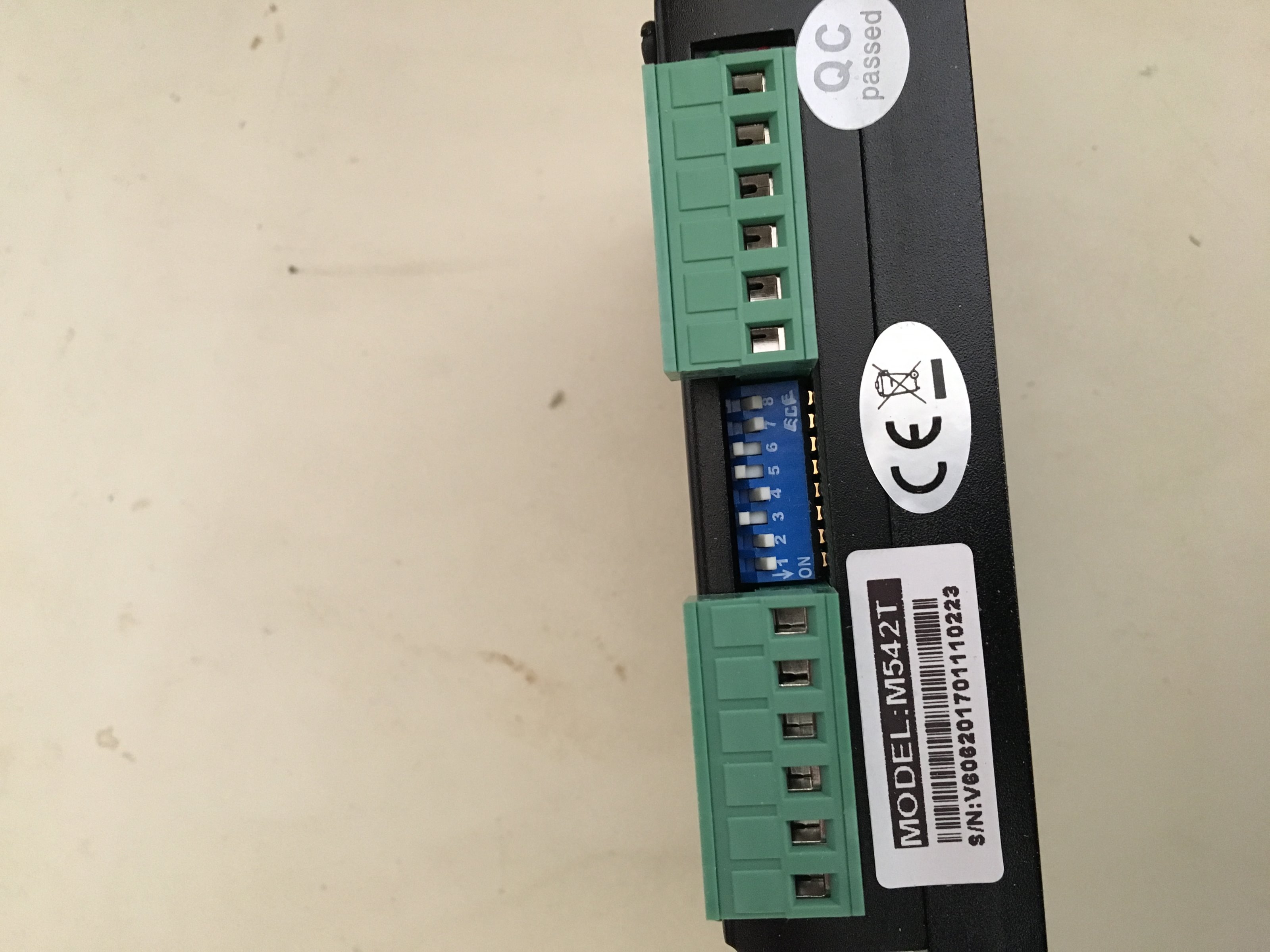

I have the pin settings on the drivers as follows:
1-On
2-On
3-Off
4-On
5-Off
6-Off
7-On
8-On

First, be sure it is a USB BOB, does it have a parallel port on it? Most of them have parallel port for comunication and a USB port for powering the board only. Also you should check for the +5V/grnd as you need that to be set to +5V OR GND and based on that vire the drive. Basicly, you need to wire all 3 + or gnd inputs to that output, and the other ones to their respective outputs.
As for the drives, take a picture and post it here showing the switches and the writing. I have 2 types from the same manufacturer and they do not have the same switch settings.

The BOB says its for a 4 Axis USB CNC Card Controller Interface Board for Mach3.
If anyone can tell if the USB is for power or not, that would be helpful. I don't think it is because you can see power supply on the top left corner of the front of the board, On the back it is showing on the top right side. You can also see all the marking points for termination as I had described earlier. Also attached is the driver and the pin settings I have selected based on best guess from information supplied by the drawing for the stepper motors 35HS45-3504S.

That breakout will not work with LinuxCNC so even it you wire the
step/dir outputs to the motor drives you cannot use it with LinuxCNC
LinuxCNC can work with parallel ports and parallel port breakouts
and PCI/EPP/Ethernet interfaces made specifically for LinuxCNC,
but LinuxCNC does not currently work with USB/Ethernet interfaces made for Mach3
(like the USB breakout you show here)
If you want help setting up and wiring the breakout with Mach3, you will likely get more help
at CNCzone or a Mach3 forum
