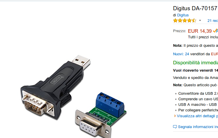

into my modbus pc QT HMI interface I use with success with toshiba VFxxx the device .... is quite good DA-70xx is the most rugged and durable ... use them in industrial environments with moisture and dust.
when you are realised the connections dip the terminals in the insulating gel into a small box. The result is perfect.
About shield pin on vfxxx... my supplier up to 100mt tells me I can do without ... At my part I connect it on DA-70xx because there is a specific pin.

Thanks for the suggestions on the RS-485 adapter. The one I'm using at present is a
Jaycar XC4132
, which unfortunately doesn't provide a terminal for shield ground. I don't believe it's galvanically isolated either (not sure if that's a big deal or not). To be honest, the cabling I'm using for this initial testing is completely inappropriate, as it's not even twisted-pair (just some spare telephone cord that had the right connector at the end already)! I was thinking I could attach the signal cable shield fairly easily to the chassis of the LinuxCNC PC, if the interference persists after upgrading to shielded VFD cable and attaching the PE ground on the (Chinese) spindle.
