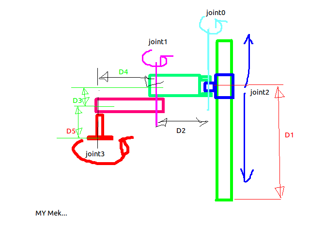

For better precision 2 image:
fanuc 510 have these config?
2 my scheme of scara, and fanuc 510 have these instead of nr.1?
I never see to work a scara fanuc so i do not know its functioning ... (correct after the andypugh intervention ... I think I could have created a misunderstanding).
I you use scarakins on master you are ready to start .... only need to insert as I suggest you the scarakins definition and call on your hal file (on top)... if you have other scarakins you must compile it with halcompile than insert the definition in your halfile as i suggest you.
We could do some experiments together to improve our knowledge. I hope you agree. Ciao.

Both those robots should be able to use the same kinematics. This will work because the Z position is completely orthogonal to the arm joints in both cases. It doesn't matter from a mathematical point of view where the Z axis actuator is.

@andypugh ... the question was not kins related but mechanical configuration related ... only for know the phisical work of fanuc 510 robot and even make some friendship.
In any case I am always in debt with you for the help you gave me here on the forum..... and I correct my last post.

05 May 2017 11:19 - 05 May 2017 11:22 #92693
by bkt
Replied by bkt on topic kinematics getting started for dummies?
my mecanicals ... in the draw you see the right number and name of joint ....
.... Z location is not important because not influence the kins math .... only you see some difference on end effector if you not insert correctly ..
from scarakins.c ...:
Actually for more semplicity in my hal file I set D1/D5 and D6 to 0 .... in these way the working area of your scara and the arm orientation is determined by your ini file and the direction of rotation of the motors. No stress to detect real measures.
I hope these help.
Giorgio

/* key dimensions
joint[0] = Entire arm rotates around a vertical axis at its inner end
which is attached to the earth. A value of zero means the
inner arm is pointing along the X axis.
D1 = Vertical distance from the ground plane to the center of the inner
arm.
D2 = Horizontal distance between joint[0] axis and joint[1] axis, ie.
the length of the inner arm.
joint[1] = Outer arm rotates around a vertical axis at its inner end
which is attached to the outer end of the inner arm. A
value of zero means the outer arm is parallel to the
inner arm (and extending outward).
D3 = Vertical distance from the center of the inner arm to the center
of the outer arm. May be positive or negative depending
on the structure of the robot.
joint[2] = End effector slides along a vertical axis at the outer end
of the outer arm. A value of zero means the end effector
is at the same height as the center of the outer arm, and
positive values mean downward movement.
D4 = Horizontal distance between joint[1] axis and joint[2] axis, ie.
the length of the outer arm
joint[3] = End effector rotates around the same vertical axis that it
slides along. A value of zero means that the tooltip (if
offset from the axis) is pointing in the same direction
as the centerline of the outer arm.
D5 = Vertical distance from the end effector to the tooltip. Positive
means the tooltip is lower than the end effector, and is
the normal case.
D6 = Horizontal distance from the centerline of the end effector (and
the joints 2 and 3 axis) and the tooltip. Zero means the
tooltip is on the centerline. Non-zero values should be
positive, if negative they introduce a 180 degree offset
on the value of joint[3].
*/Actually for more semplicity in my hal file I set D1/D5 and D6 to 0 .... in these way the working area of your scara and the arm orientation is determined by your ini file and the direction of rotation of the motors. No stress to detect real measures.
I hope these help.
Giorgio
