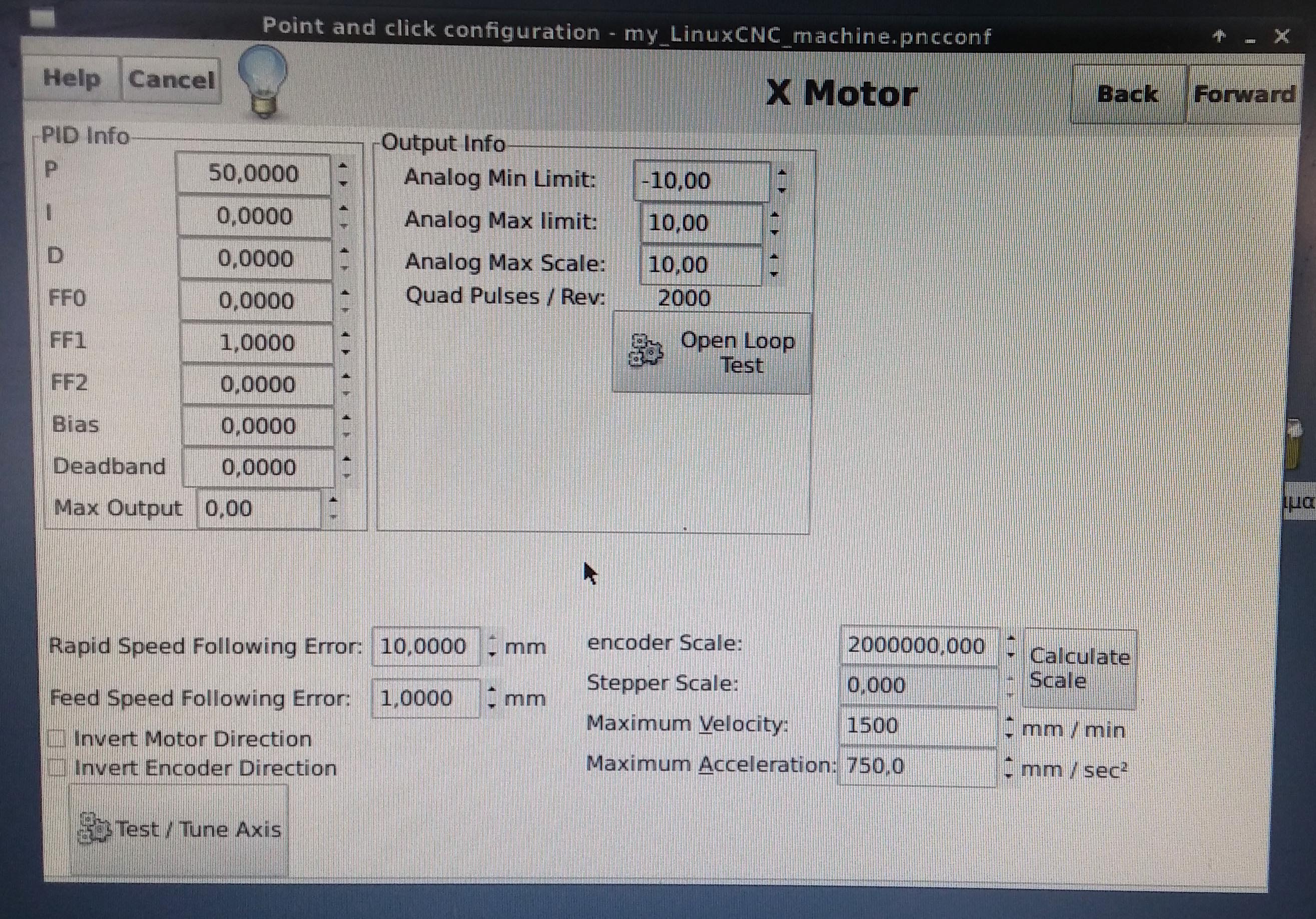

02 Jun 2017 13:00 #94005
by Yannis
Replied by Yannis on topic MESA 5I25 7I77 CAN DRIVE THIS MOTORS??
Hi again
i have a problem with the calibration of the motors
in x axis i have from motor to ballscrew 1/2 pulley reduction and i have a ballscrew with 20 mm pitch
so i need 2 full rotations of the motor to rotate 1 time the ballscrew and moove 20 mm
so in one rotation of the motor i must have 10 mm of movement
my motors have encoders with 2000 steps per revolution
when i jog i see the motor rotate like crazy and in the MDI the numbers are fractions of mm
what is your suggestion
- Todd Zuercher
- Posts: 4786
- Thank you received: 1476
02 Jun 2017 13:31 - 02 Jun 2017 13:36 #94007
Replied by Todd Zuercher on topic MESA 5I25 7I77 CAN DRIVE THIS MOTORS??
The encoder scale should be steps/mm or in your case probably 800 (8000 quadrature/rev/10mm/rev)
