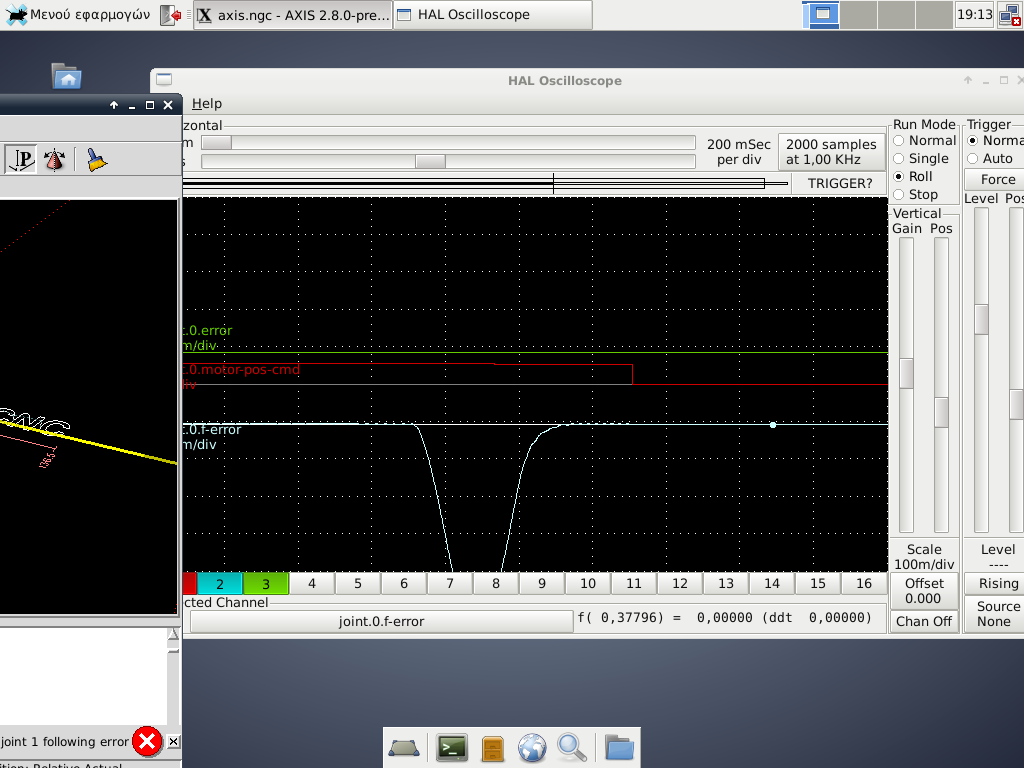

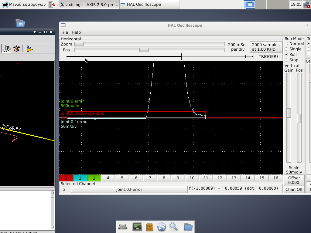

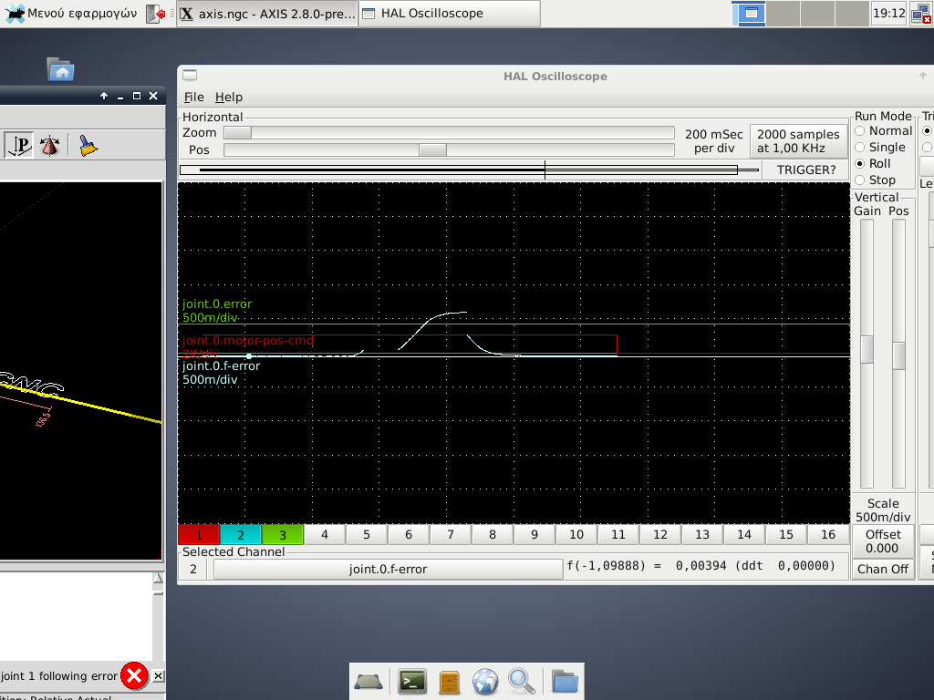

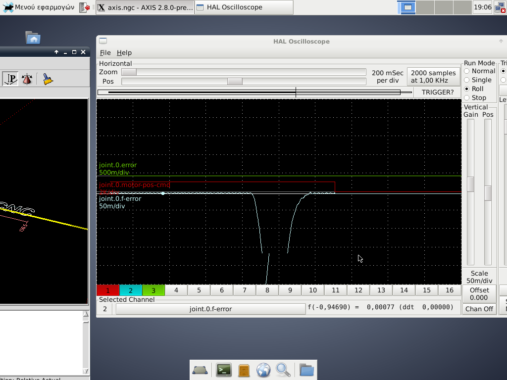

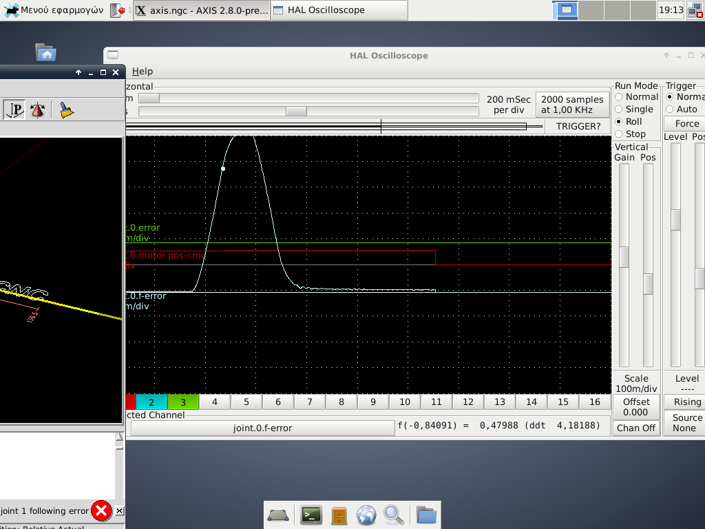

is this of any use?
- Todd Zuercher
- Posts: 4786
- Thank you received: 1476
06 Jun 2017 18:21 #94190
Replied by Todd Zuercher on topic MESA 5I25 7I77 CAN DRIVE THIS MOTORS??

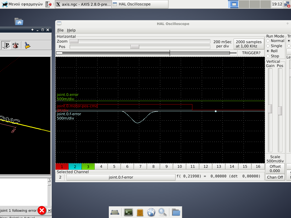

Not much. What's up with the broken f-error trace on the 3rd and 4th screen shots?
Change channel 3 to "axis.0.joint-vel-cmd" and set the trigger to channel 3.

Hi
i manage to drive the motor with speed7500mm/min in my the maximum setting
the p is1.75 and when i try to increase i have vibration of the motor and drive fault
the ff1 is 0.038 and if i try to increase i have joint error so my question is is there normal or average numbers for that
or every system have different configuration?

hi my encoders is 2000ppr

In that case you have the encoder_scale wrong also, it should be the encoder counts per unit (mm or inch)X4, so stop tuning and fix those, everything you change will have a major impact in the tuning.
forum.linuxcnc.org/10-advanced-configura...ning-detailed-how-to
gnipsel.com/linuxcnc/tuning/servo.html
But first make sure you have those settings right.
Replied by tommylight on topic MESA 5I25 7I77 CAN DRIVE THIS MOTORS??

Now, Tommy don't confuse the poor guy further. His encoders are 2000 pulses/motor revolution but through belt reduction and his ball screw he has 10mm of travel/motor rev.. (I think 800 is right with x4 quad.)
