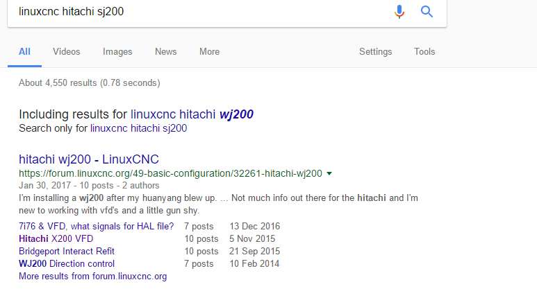

was that hitachi model no a typo??

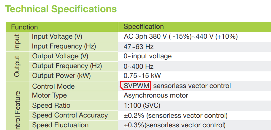

Also, i was browsing my local hardware stores for some vfds, and came across the HH100 series by Hitachi.
Its documentation mentions SVPWM as a control mode.
I was wondering if this is the same as the PWM that is obtained on the PWM pin on the linuxcnc using mach3 interface board. It would be great since this would require no setup this way..

SVPWM refers to a control method INTERNAL to the vfd. Its a sensorless vector drive, which is a higher end drive that exhibits better speed regulation. Don't know if you noticed, but the spec sheet you posted says its a 380-440 volt 3 phase drive, great if you have that power available, very bad if you don't.
All vfd's will require some programming within linuxcnc. You have to setup the min and max speeds, output pins and such. This is different with each machine so there are no canned configs. Its pretty easy to do though and a lot of examples out there.
