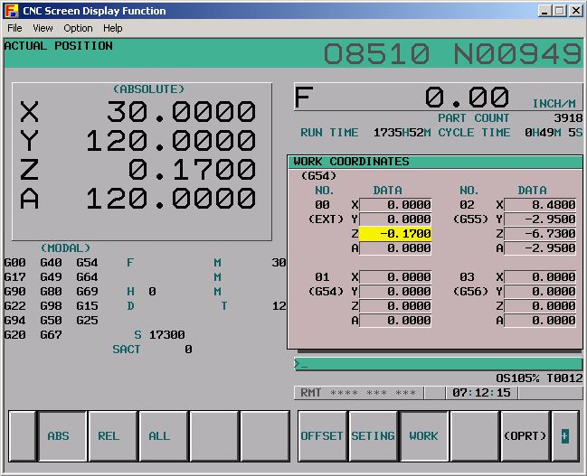

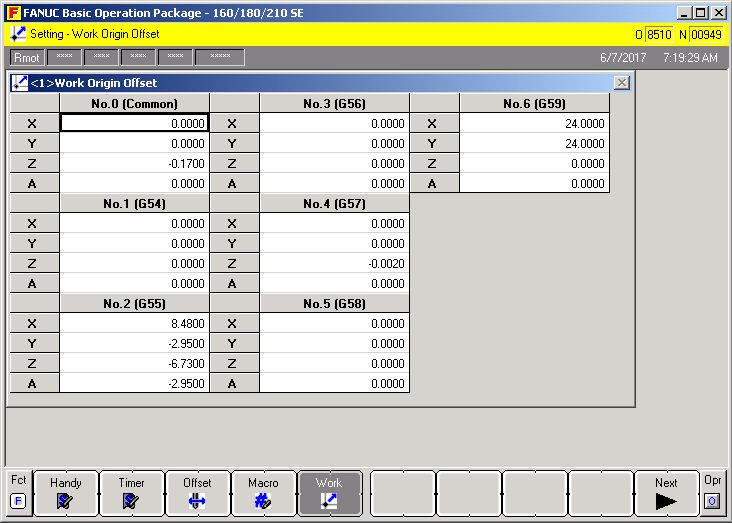

I am a noob using axis GUI and wanted to know if the values of G54,G55... Offse values can be viewed in a table or atleast edited in some way. I ask because i use this in fanuc systems.
Thanks in advance.

I think most of the glade based UIs have something at least sort of equivalent.

I had the idea of embedding a gladevcp tab in axis using the offsetpage widget like what is used with Gscreen (and I think Gmoccapy.) but I'm having trouble making it work.
