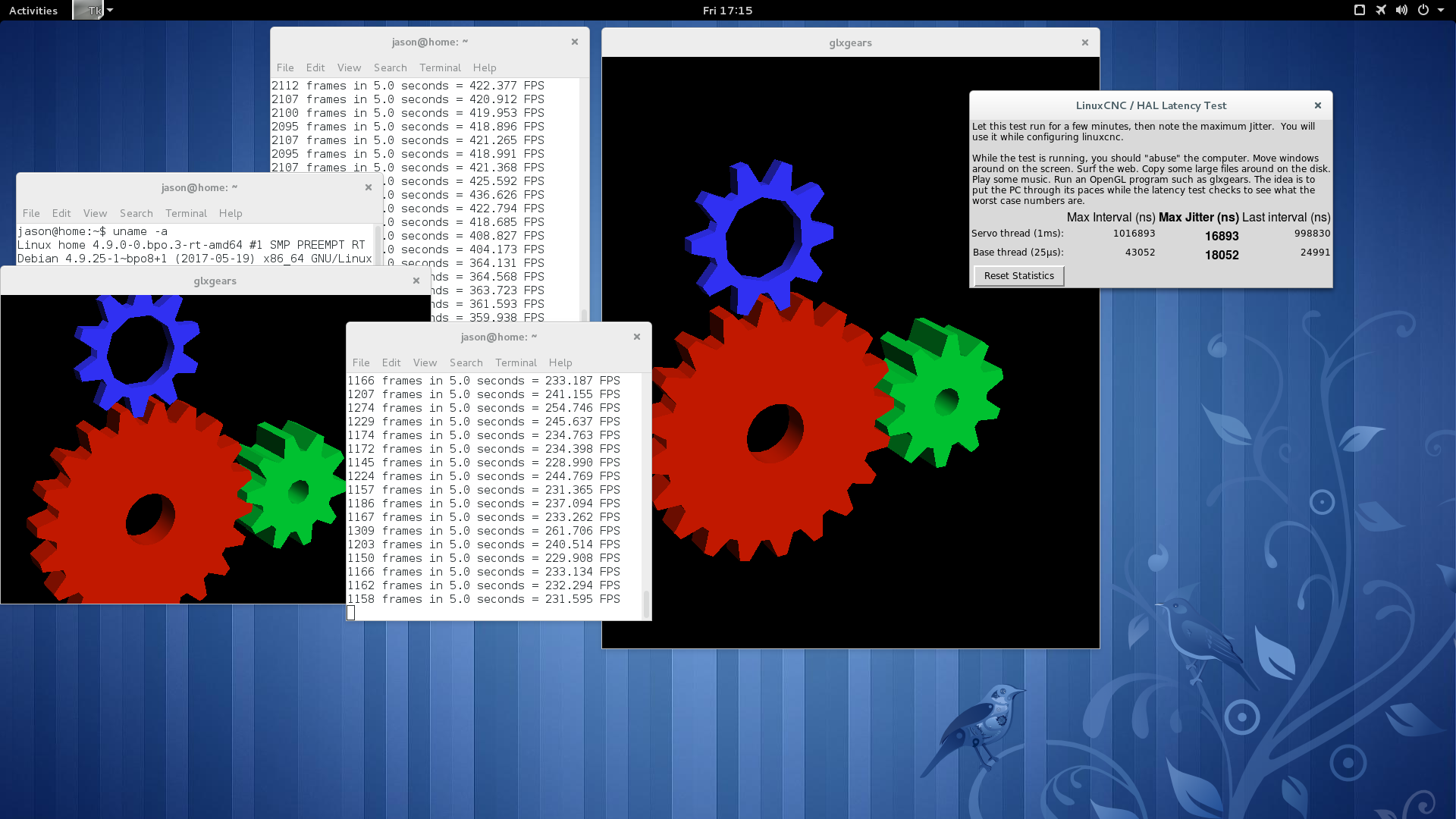

Debian 8.8 rt more jitter than wheezy

- Posts: 18105
- Thank you received: 5328
09 Jun 2017 15:50 #94359
Replied by PCW on topic Debian 8.8 rt more jitter than wheezy
is Wheezy using the same Preempt-RT kernel?

09 Jun 2017 17:12 #94367
by zack
Replied by zack on topic Debian 8.8 rt more jitter than wheezy
Linux home 4.9.0-0.bpo.3-rt-amd64 #1 SMP PREEMPT RT Debian 4.9.25-1~bpo8+1 (2017-05-19) x86_64 GNU/Linux
this kernel for debian 8.8

09 Jun 2017 17:47 #94370
by zack
Sorry No
Linux debian 3.4-9-rtai-686-pae #1 SMP PREEMPT Debian 3.4.55-4linuxcnc i686 GNU/Linux
this one on Debian 7x
Will try optimize , proceses, cores, gnome, hardware drivers, etc

09 Jun 2017 18:12 #94373
Yes, your Wheezy and Jessie systems are running totally different real time kernel types
Its expected that a RTAI kernel will have lower jitter numbers than a Preempt-RT kernel
Note that worrying about jitter of these magnitudes is only important if you are running a
parallel port system.
