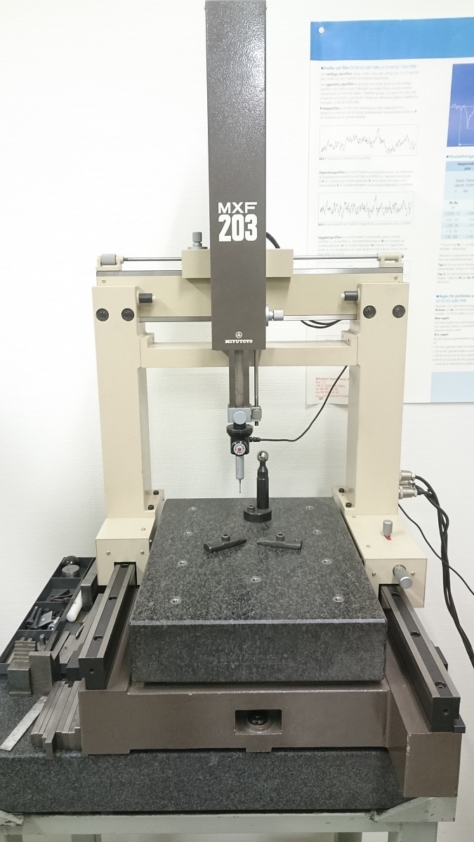

Look from 2:16 Perimeter tracing and save data to file as DXF ( and/or CSV ).
I have a small manual Mitutoyo coordinate measuring machine that I would like to get automated.
Goal is to have full 3D perimeter probing to file with preferably STL format. 2D to DXF will help a lot.
Have need to probe parts that no longer are available as spare parts.
I have Probe-It plugin in for Mach but would like to move all my machines to LCNC.

Hallo Benqt,
I am pretty sure, that it can be done. There is already a feature for probing, that will send the point coordinates to a file.
Your question will need a lot more maths, as the tool in the video does probe in different directions, etc.
I am very interested in your way to solve this issue, as I do have also a MITUTOYO machine I want to retrofit, I was thinking of using Acurite QC 5000 Software (now it is Heidenhain), as that one has all the maths included. As I am a metroligy Engeneer, I have the advantage to use several machines from my company, so I have this on the very last point on my todo list.

Hallo Norbert,
First of all I will keep original electronics as is, only picking up the signal from the glass scales amplifier and do some sinus to quadrature conversion and feed my controller Gecko 320X and Mach3 with Probe-It plugin but I would like to go all in with LinuxCNC.
So is there any software that reads point cloud files without any problems and spits out STL?
Bengt

I want to do the same but with a laser and a webcam, I would need to write a python component and there are libs out there to write stl and dxf
but sadly i don't goin to start this project soon
so if you have the signal of the probe wired to linuxcnc a python component could read the position of the machine and add a vertex or point to a dxf/stl

About one year ago I made a small python program that converts a linuxcnc probe log file in a DXF file. On this file the probing points are represented by a circle (but can be easy changed to draw lines between the log points).
I used this on a plasma cutter, where I "probe" with a laser the sample shape , or a metal sheet with hand made drawings.
there is the unfinished project:
jtctech.pt/download/jtc_dxf_writer.rar
regarding the probing, the direction can me discovered by the 2 last probe points, If you probe the next point perpendicular to that direction I think that will result like on the video.

I think that the implementation of this would depend on the type of probe being used. Strain gauge probes can give extra information about the direction of touch, and I think this is what the
part-tracing CMMs
use, rather than a simple touch-probe.
Part tracing with a touch-probe has to guess what angle the probe is touching the part at.
I imagine that you would simply assume that the current point is an extension of the line through the last two points during the scanning process, (to calculate the next probe-start position) then calculate a better guess a the real tangent once all the points are gathered.

Thanks Andy,
I am aware of the shortcomings with linear probing but it would be better than nothing.
Probe heads I have are TP6 and TP2 5W for this machine.
The pseudo code explains the operation very well.
