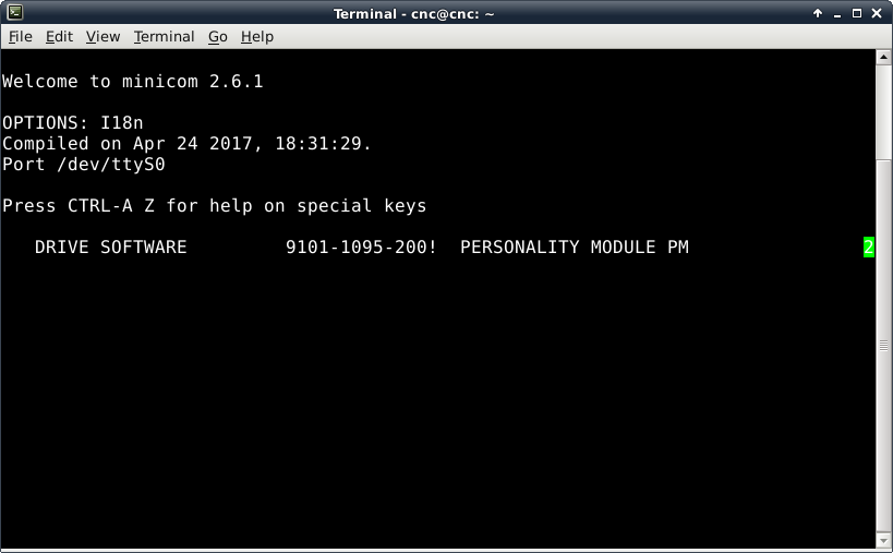

According to the manual to tune the motor or use the AUTO TUNE FUNCTION of the driver i have to use a TANDY 102
(PAGE 36) that is not possible
It also says "VT52" and there are lots of ways to emulate that with modern hardware, including using the LinuxCNC PC assuming it has a serial port.
See, for example, the discussion here: unix.stackexchange.com/questions/22545/h...-simple-as-using-ssh
I have used "screen" on my Mac to monitor the low-level BIOS output of a single-chip computer. It definitely ought to work.
The following user(s) said Thank You: Yannis

i try to auto tune the motors and the drivers via serial communication
i install minicom to establish communication threw linux pc and the driver
when i enable the driver the minicom terminal saw the correct message in the terminal screen but ether the escape or th P key are not working any suggestions?
