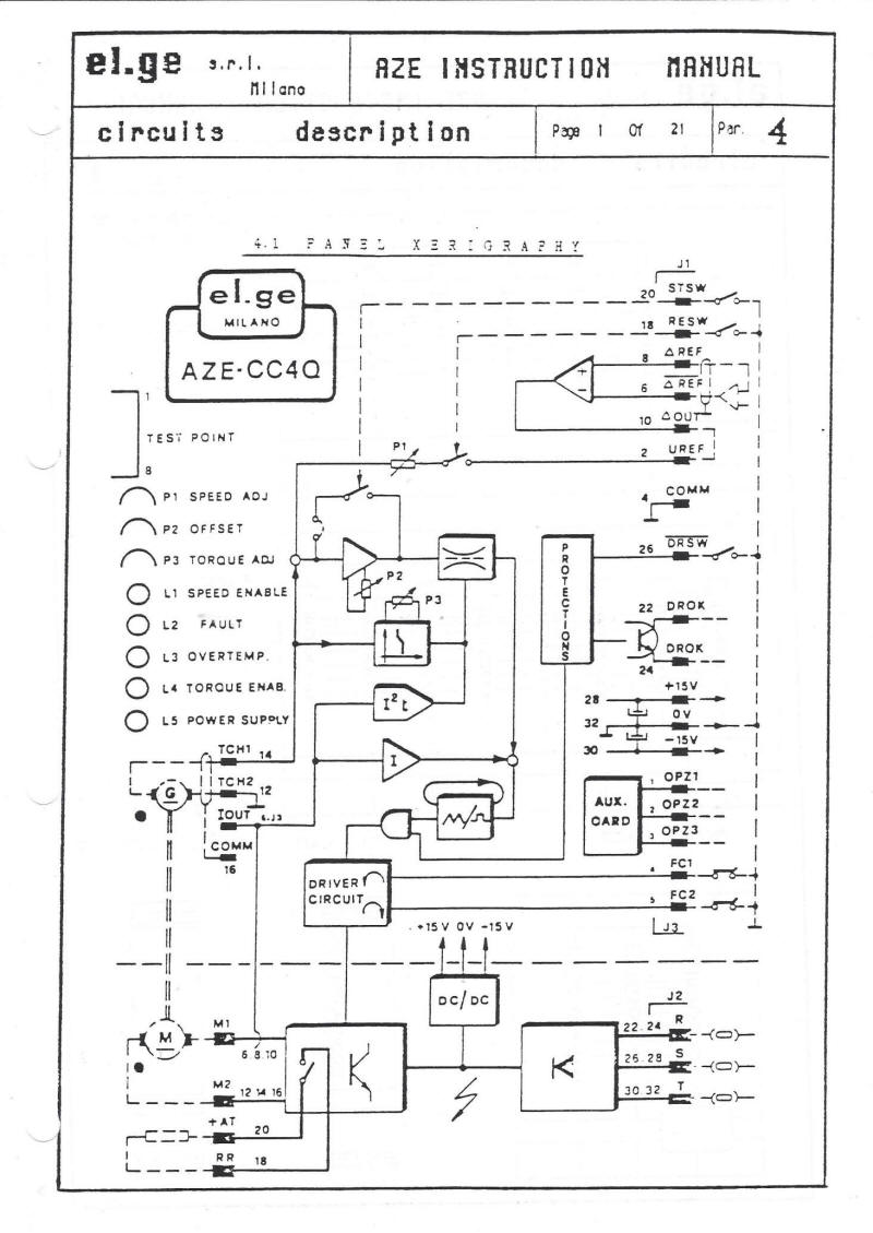

I have some pages of manuals but there is not alot of info. What I can see is it has +-10 velocity control and it says tach but the actual DC Servos has incremental encoders. the manual only show one wire per axis out for position. Should I put a board in between the encoder and drive to split the signal, one side go to 7i77 and the other to the drive.
/EDIT Or will this work like single ended encoders back to the 7i77?
I will attach the manual.

Do you know if the original installation was using the encoder to create a simulated Tacho signal? Or perhaps the drives were being used in torque mode?

I think that some people have managed to use an analogue output from LinuxCNC as a simulated tachometer signal.
It's hard to know if the original controller did something similar.

These have a tach on th emotir and an encoder. The differential encoders went directly to the control so we are set.
