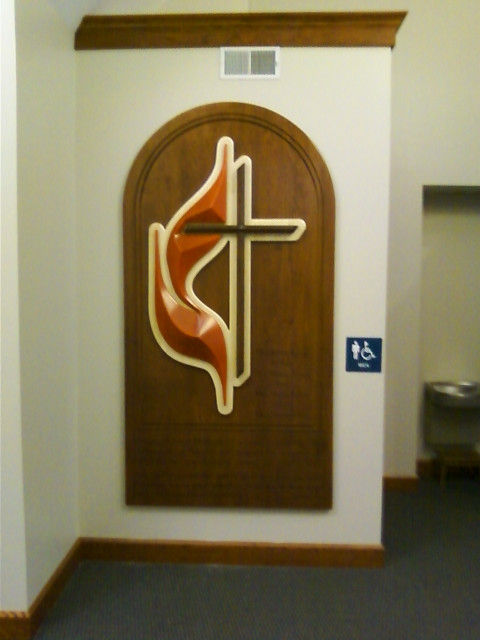

p.s. unless someone can give me better advice, i have decided today to subscribe to autodesk's "artcam" software for my cam software needs. the monthly subscription price versus the software abilities seems to be the best bet.
currently, i am using coreldraw for my cad requirements and of course linux cnc for the milling. for the cam, i have tried numerous offerings (via trial software). certainly vectric is nice, but cost prohibitive, with deskproto as runner up, but also cost prohibitive (in both cases a "commercial" license is required for reselling anything made with their software.
i realize that a simple answer is to just use the less expensive software illegally, but unfortunately this is not something that i do. after all , i wouldn't like it if someone just took my work and used it to make a profit.
so, am i making the right choice for cam software?
jacques
there are no words to describe my awe. but, my horizon has certainly been broadened. nice stuff monsieur garrett.
jacques
jacques

You might want to look at Fusion360. That is free for hobby, education and "startup" use (and their definition of "startup" is quite generous, and you self-certify)
It has very good CAM, based on HSMWorks.
ArtCAM might be better for your application, I have not looked at it.
Replied by andypugh on topic how can i use my linuxcnc router manually?
