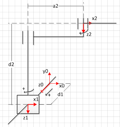

Hi, i have a problem need help.
example, i have an arm robot (TRR). i want to use T(trans) to control axis X and RR(rot) to control only axis Y. there is a equation decribe relationship between R1 and R2 like R1 = f(R2).
The way to control the robot in world mode by inverse kinematic is easy but how do i control the robot in joint mode, the input only T and R2? What is the loop-control used in joint mode:
joint input---> forward kinematic---->inversekinematic--->joint output
>control motor---->joint input.

- Todd Zuercher
- Posts: 4786
- Thank you received: 1476
29 Sep 2017 15:24 #99621
Replied by Todd Zuercher on topic anyway to control 2 axis (not standalone) by 1 input
The kinematics are not used in Joint mode. Joint mode is direct control of the motor.

- Todd Zuercher
- Posts: 4786
29 Sep 2017 15:58 #99626
What exactly are you trying to accomplish?
Some sort of coordinated jogging that isn't the same as world mode, or joint mode?

- thang
- Posts: 196
- Thank you received: 11
30 Sep 2017 05:18 #99661
by thang
Replied by thang on topic anyway to control 2 axis (not standalone) by 1 input
Just confirm my problem is solved, tks you very much
