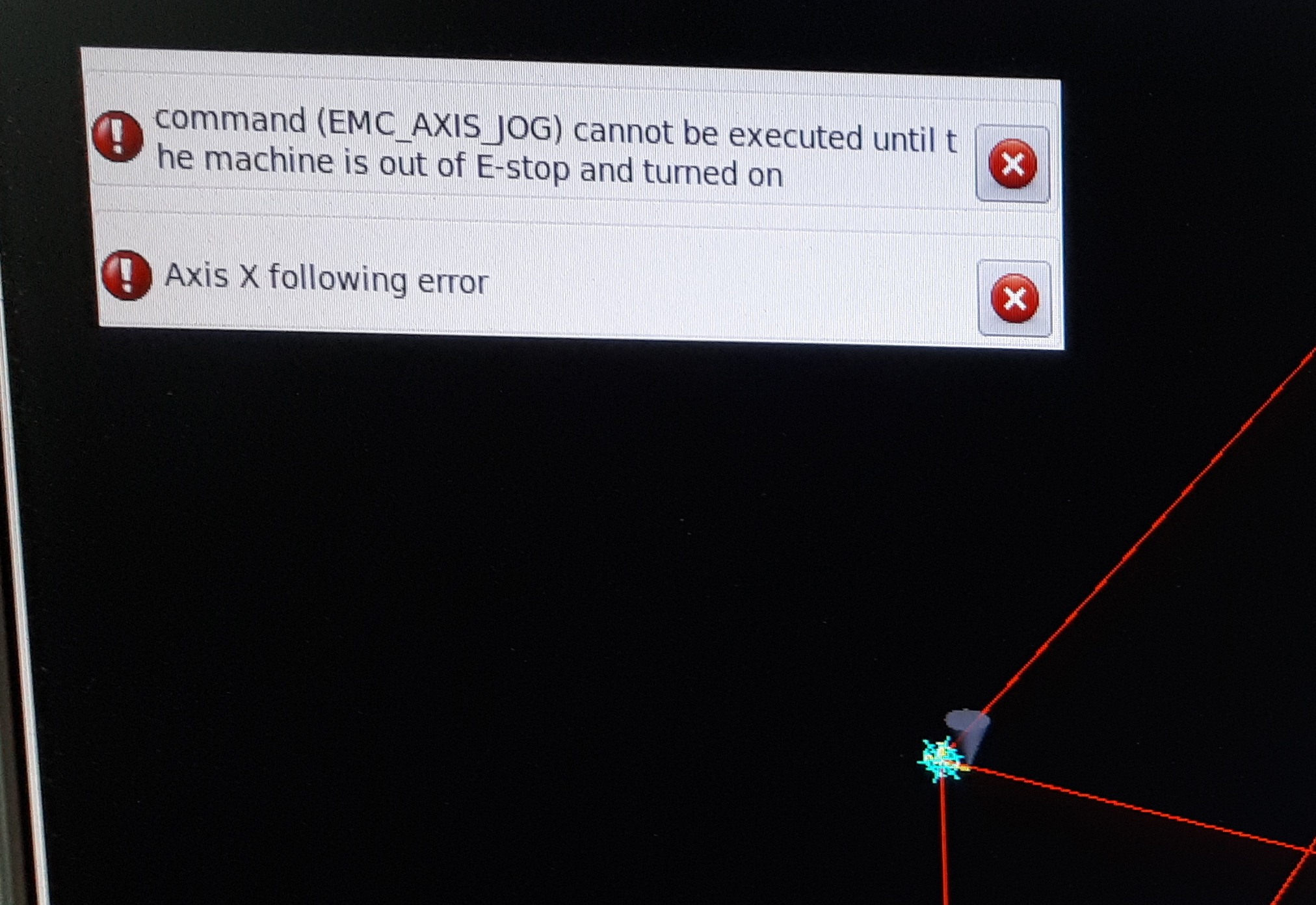

Shortly! Machine run with 3 stepper motors, one per axis. To provide movement each axis has the screw diameter 16mm, 5 mm pitch and related ball nut 16mm. For all axis, there are limit switches connected, homing is doing well. Speed of machine of each axis easily 7500 mm/min with acceleration of 350 mm/s2. While cutting 2D, or curving 2.5D no problem at all. I am fine. Running 3D model, works as well fine. However, I wanted to speed it up, thinking with low acceleration I am loosing time. When I set the acceleration to 500 mm/s2, and pressing respective arrows key on keyboard, movement engaged at max speed, no loosen steps, but when the key was released machine stopped immediately and interrupted (machine is set OFF), saying ''the home switch triggered", though there is still room to reach limit switch.
is there anybody facing at least similar issue, to advise me what to do?

06 Nov 2017 18:35 #101448
by probamo
Replied by probamo on topic Machine Interruption - high speed higher accelation
I tried to modify HAL file following this instruction:
forum.linuxcnc.org/38-general-linuxcnc-q...al-debounce?start=10
Unfortunately no improvement made. Hereafter enclosed INI and HAL files. The latest one with (lines 10, 11, 46 - 54) and w/o modification, if somebody could help me.
With modified HAL acceleration of 350mm/s2 works, but with higher e.g. 500mm/s2 machines stopped and screen-shot of message is attached.
Thank you.
Thank you.
- Posts: 18105
- Thank you received: 5328
06 Nov 2017 19:14 - 06 Nov 2017 19:16 #101453
Replied by PCW on topic Machine Interruption - high speed higher accelation
OK, this is not a limit switch problem but more likely an issue with the stepgen (following error)
If you look at your maximum step rate (160 steps/mm*125 mm/S = 20 KHz), its _very_ close to maximum possible step rate
at your base thread period (1/48076 = 20.8 KHz)
I would try lowering the the maximum velocity (say to 100 mm/S) to see if that solves the issue
EDIT
If you set the acceleration to 500 mm/S^2 you must also set the stepgen max-accel parameter to about 625 mm/S^
EDIT
Last edit: 06 Nov 2017 19:16 by PCW.

07 Nov 2017 18:54 #101504
by probamo
Replied by probamo on topic [SOLVED] Machine Interruption - high speed higher accelation
Thanks PCW.
Indeed I passed through stepconfig once again. Started with max velocity 100mm/s and increased acceleration up to 500mm/s^2. Started machine - run well. Then I reset max velocity to 125mm/s^2, and acceleration 1000mm/s^2. Due to less velocity in reality, manually adopted velocity in INI file for each axis. In stepconfig reported that with given settings, acceleration should take place as fast as 0.1s to reach max velocity. I'll give a try in coming days, with some 3D curving project and see benefits.
To make sure, I left ''debounce'' modification I made the other day in HAL file.
Once again thanks a lot for support.
Cheers,
