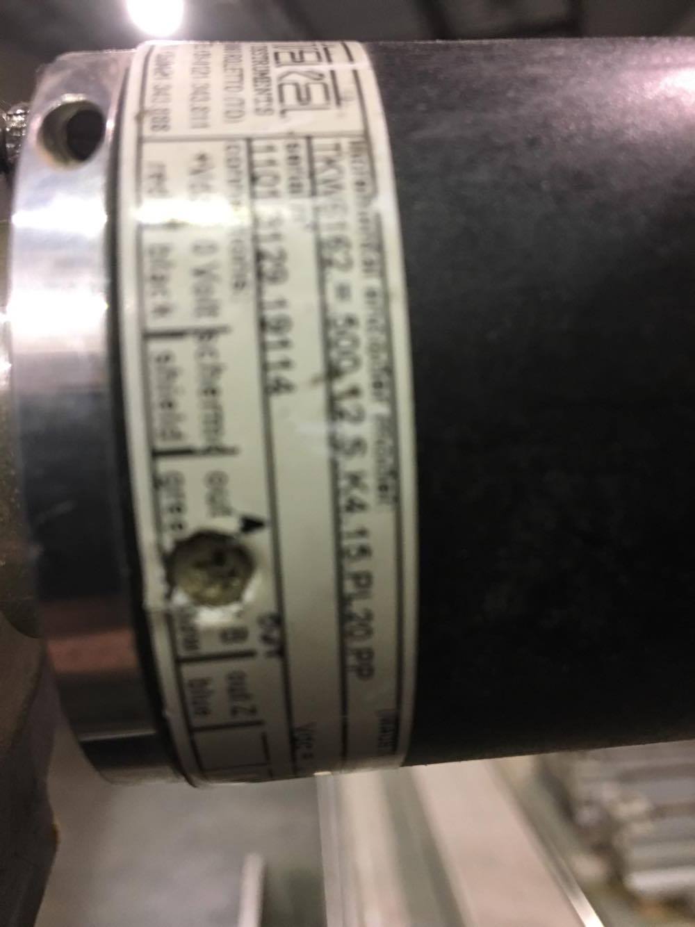

Can i connect 12v single ended encoders to 7i77 encoder inputs?
/edit i guess i could put resistor on each leg. Thses are single ended encoders.

The input chips used 26 are protected against +-25V inputs, but 12V is just at the edge of their common
mode range so I'm not sure it would work reliably
Because of the 2K Ohm pullups to +5V on the TTL inputs, its probably best to use a resistor divider with
2 resisitors per input. Because of the 2K pullups this divider should be low impedance, say
12VENC --> 470 Ohm --> 7I77Input -->220 Ohm --> GND

These are Incremental encoders tkw6162 models.
They are 12v, so I will do lik you said and put resistors.
I dont know what kind of outputs they are. I am looking for them.
Looking further details at this site: www.italsensor.com/tkw615c/

Would this be correct?
Replied by bevins on topic 7i77 and 12v single ended encoders
- Posts: 18105
- Thank you received: 5328
03 Nov 2017 16:41 #101269
Replied by PCW on topic 7i77 and 12v single ended encoders
Yes, that looks correct with one addition, the 12V ground must be common with the 7i77 encoder ground.

Do they work at 8V? 5V? Might be worth finding out.
Replied by andypugh on topic 7i77 and 12v single ended encoders
They are 12v,]
The following user(s) said Thank You: bevins

I'll try them at 5, then up them to 8 and see if they work
If not I guess I will do the voltage devider option as depicted in the drawing.

Imagine that..... they are working with 5V.
They are 12v,]
