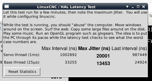

Hi
I have a running system with a mesa 5i25-7i77 setup running a knee mill with servos. If I wanted to add a stepper motor to the setup could the 7i77 handle both?
Or would I need to add an additional card?

You can do this but it typically requires an additional breakout/daughtercard connected
to the 5I25s P2 header
( Unless you want to drive the step/dir pins directly from the 5I25 pins )
A simple Mesa breakout like a 7I78 will work as will one of the ubiquitous "5 Axis Mach3"
BOBs on Ebay

- Posts: 18105
- Thank you received: 5328
30 Nov 2017 04:10 #102519
Replied by PCW on topic 7i77 handle servos and a stepper?
Yes, that's fine ( it could be considerably worse and would still be ok )
