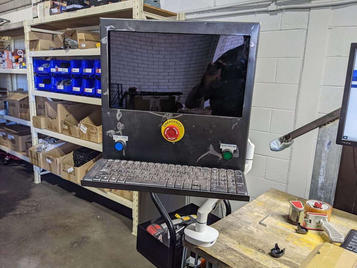

I put the real hardware on my desk....
Replied by rodw on topic Simulation of Mesa config
Thats alright for the 7i76e but did you note the 7i73 adds another 74 pins?Nop
