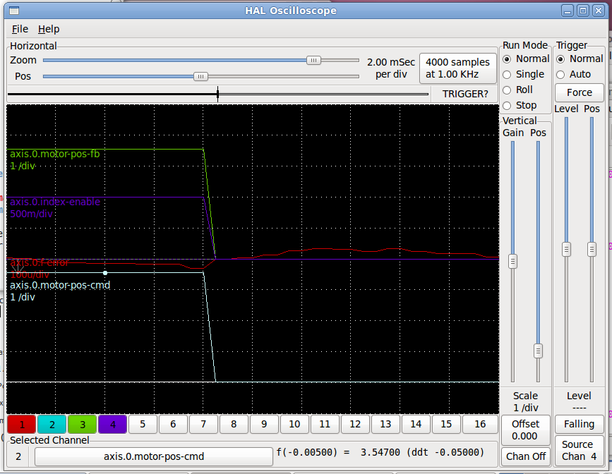

PID and Homing with index.

09 Dec 2017 23:18 #102854
Replied by PCW on topic PID and Homing with index.
Note, here is the expected behavior
freeby.mesanet.com/home-index.png

10 Dec 2017 00:34 - 10 Dec 2017 00:51 #102856
by UAVpilot
Replied by UAVpilot on topic PID and Homing with index.
Found the reason. These are the linesis necessary to place too after
Thanks to all!
addf motion-controller servo-threadaddf hm2_7i92.0.read servo-threadThanks to all!
