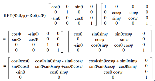

I was reading posemath library and getting a problem.Seem, there are some wrong functions in this library.
Example, here is roll-pitch-yall rotation:
and here is function "pmMatRpyConvert" in github.com/LinuxCNC/linuxcnc/blob/master...posemath/_posemath.c :
int pmMatRpyConvert(PmRotationMatrix const * const m, PmRpy * const rpy)
rpy->p = atan2(-m->x.z, pmSqrt(pmSq(m->x.x) + pmSq(m->x.y)));
if (fabs(rpy->p - (2 * PM_PI)) < RPY_P_FUZZ) {
rpy->r = atan2(m->y.x, m->y.y);
rpy->p = (2 * PM_PI); /* force it */
rpy->y = 0.0;
} else if (fabs(rpy->p + (2 * PM_PI)) < RPY_P_FUZZ) {
rpy->r = -atan2(m->y.z, m->y.y);
rpy->p = -(2 * PM_PI); /* force it */
rpy->y = 0.0;
} else {
rpy->r = atan2(m->y.z, m->z.z);
rpy->y = atan2(m->x.y, m->x.x);
return pmErrno = 0;
The condition should be "fabs(rpy->p - (PM_PI/2)) < RPY_P_FUZZ", replaced 2*PM_PI by PM_PI/2

13 Dec 2017 14:39 #103080
Replied by andypugh on topic posemath library is incorrect
Can you raise this as an issue on the bug-tracker?
github.com/LinuxCNC/linuxcnc/issues
(You can link to the post here rather than repeat all the equations)

16 Dec 2017 03:22 #103154
by thang
Replied by thang on topic posemath library is incorrect
ok, i did
