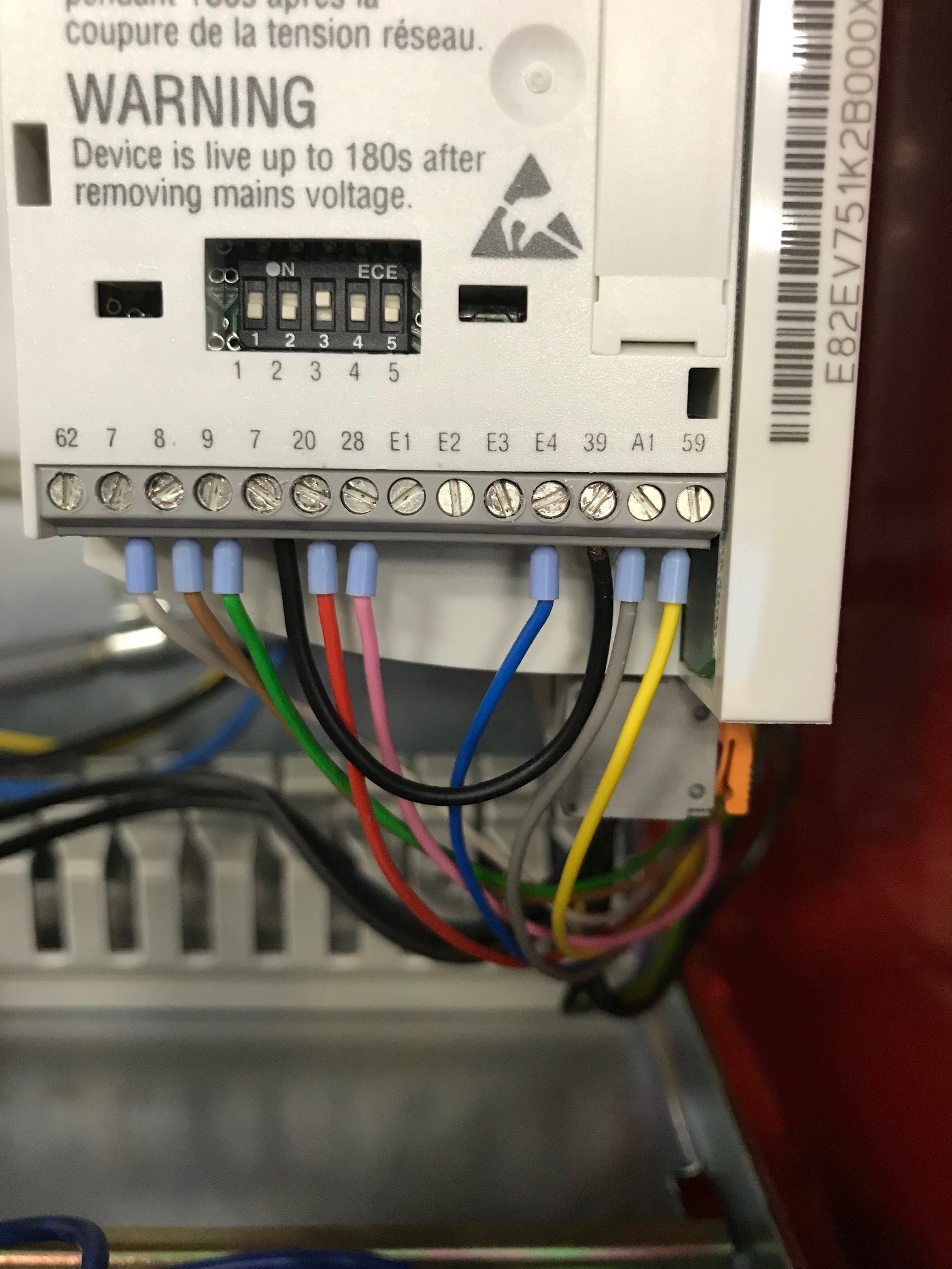

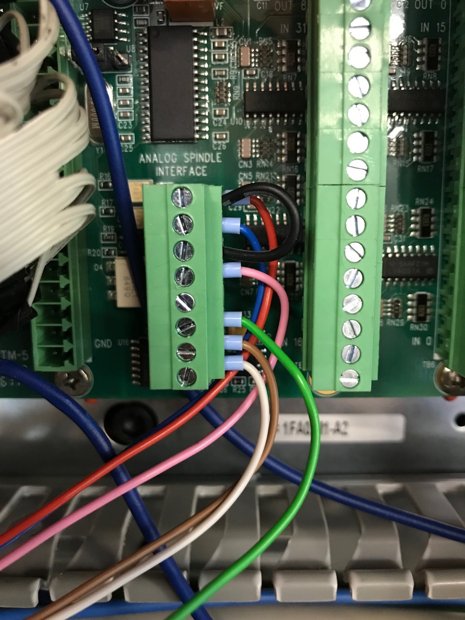

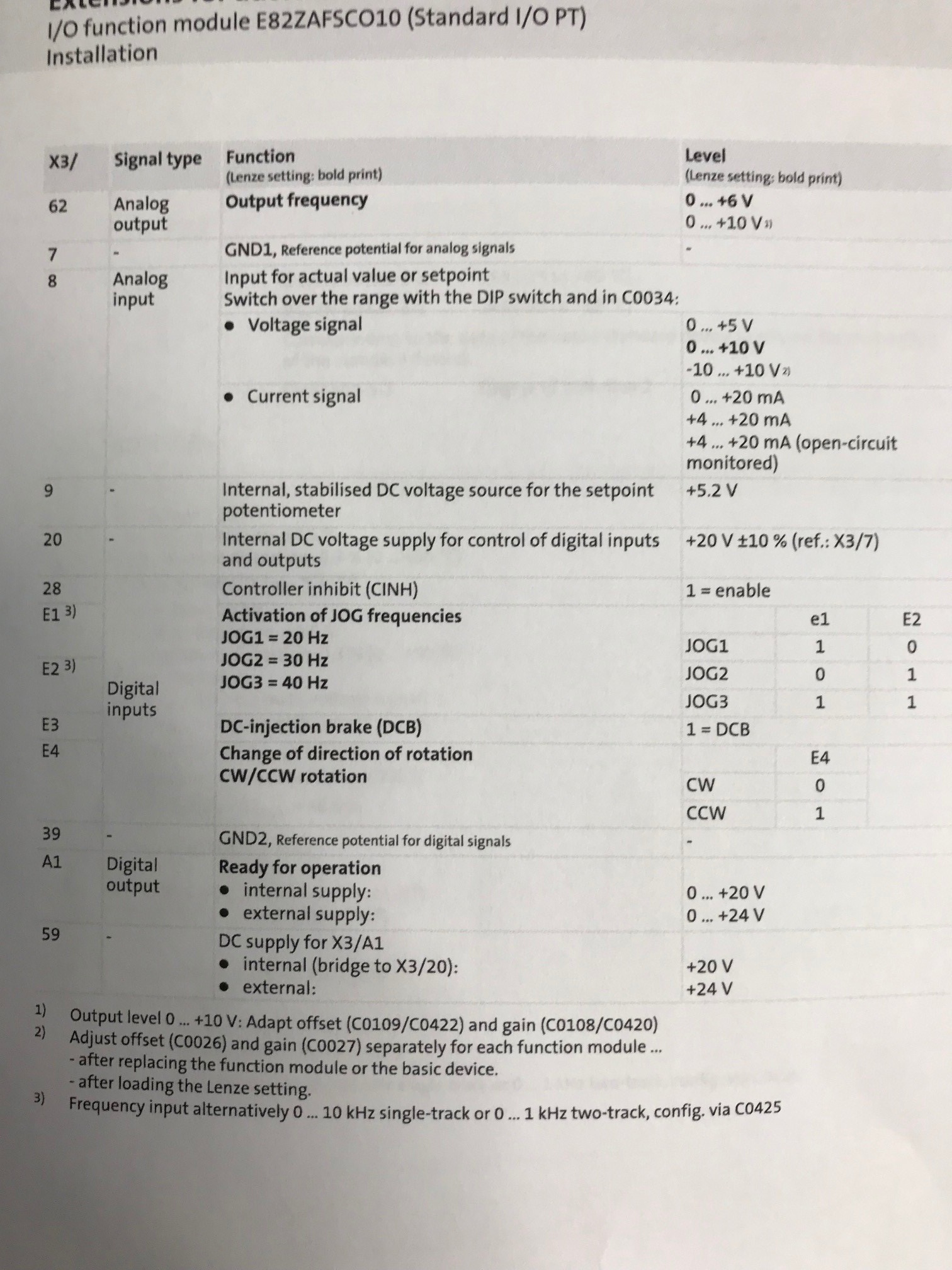

26 Dec 2017 19:55 #103709
by zmcdona1
Replied by zmcdona1 on topic Spindle jumpy when slowing down.
i reconfirmed my wiring but my spindle still spins backwards at about 10 rpm when its supposed to be off.
i attached pictures of my wiring and what the connections are in the manual.
Just wanted to confirm that im not wiring it wrong. i cant get it to work in open loop mode either.
Thank you
Thank you

Replied by PCW on topic Spindle jumpy when slowing down.
You could either zero the offset in your VFD or set the ini file spindle PID bias setting to 17
