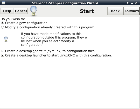

Here is the issue... I create a simple machine (using a paraport) and add to it a pyVCP or gladeVCP. Say that I want to share it, or have someone without a paraport take a look at it.
If I take that configuration... let's call it "My_Mill" and put it into another folder called "SIM_My_Mill"... what do I have to modify/add to the files/folder to make it run as a simulation?

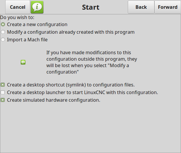

26 Dec 2017 12:25 #103636
Replied by cmorley on topic SIMULATION MODE - How do I modify an existing creation into a simulation?
Since my laptop has no parport hardware, the parport module will not load - killing the linuxcnc session.
Stepconf can use a substitute module for parport, which really just passes the signals thru it to fake signals.
This allows the config to otherwise be the same - all the main signals and pins are the same.
It does add a HAL file that adds some extra components and signals to connect up fake limits (based on the INI file) etc
You could - in theory - connect a MESA card through the fake pins and run a stepconf config with a mesa card, but the idea was for it to be able to be run on any computer regardless of hardware.
It sould be as simple as ticking the box on the start page - of course if you have modified the config before you made a simulated one then that would be more difficult.
But it requires linuxcnc 2.7+ version
