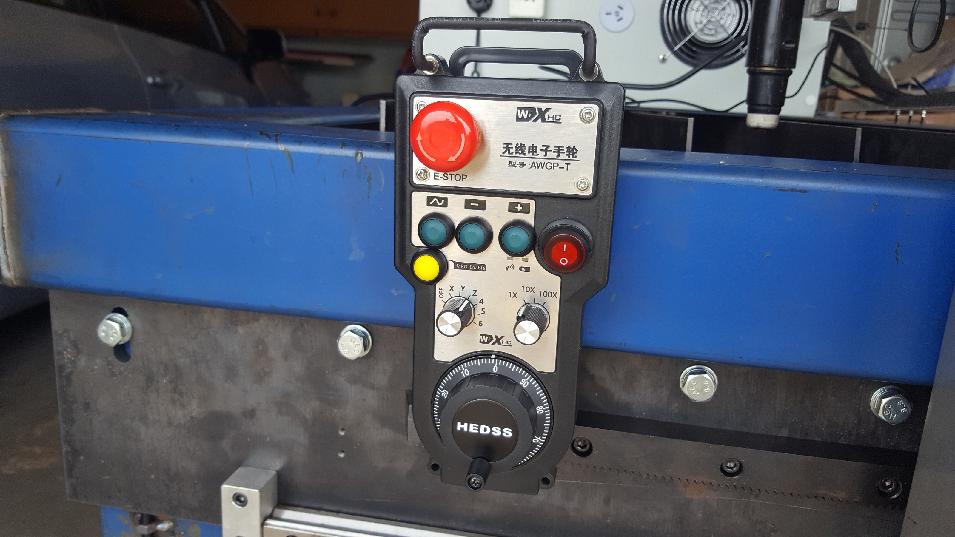

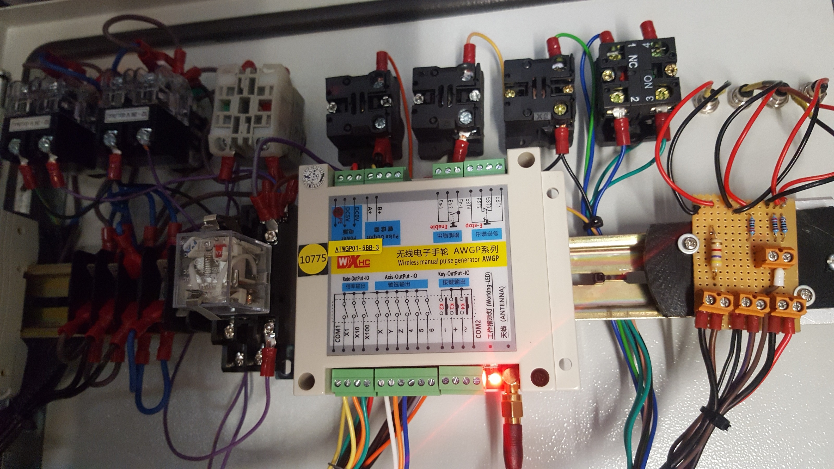

I run this on my 7i76e.
Pricey, but a real nice 433 Mhz wireless unit that can be purchased in a version that is 100% compatible with the 7i76e MPG
xhctech.en.alibaba.com/product/607207373...rator_for_FANUC.html
The receiver is a relay box with an external antenna that you just wire in to your control box
