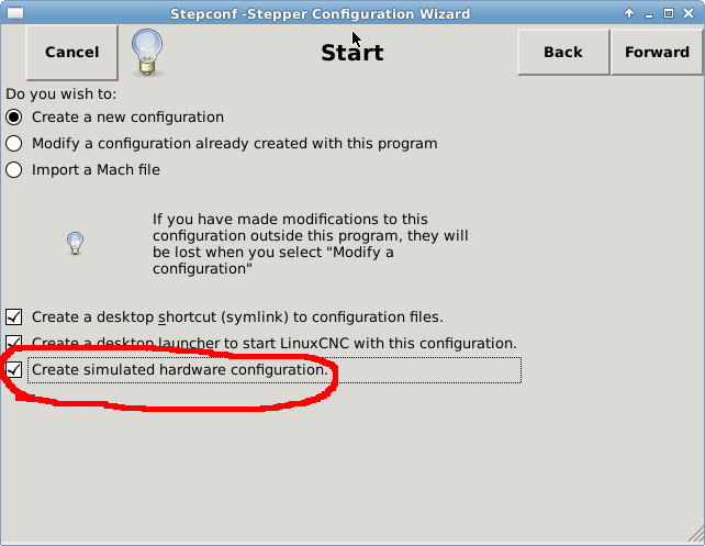

28 Dec 2017 13:27 #103790
Replied by Todd Zuercher on topic Stepconf jog is working but AXIS will not move the engines
I should have noticed this right away, but I was too lazy to bother looking at your configuration files. After having a quick peek the answer is obvious.
When you started setting up your config in Stepconfig, it looks like you selected the "Simulation" option check box on the first screen. Rerun Stepconfig and uncheck that box.

- ragt
- Posts: 5
28 Dec 2017 18:59 #103801
by ragt
Replied by ragt on topic Stepconf jog is working but AXIS will not move the engines
Thank you Todd for the solution.
It is now working.
It is now working.
