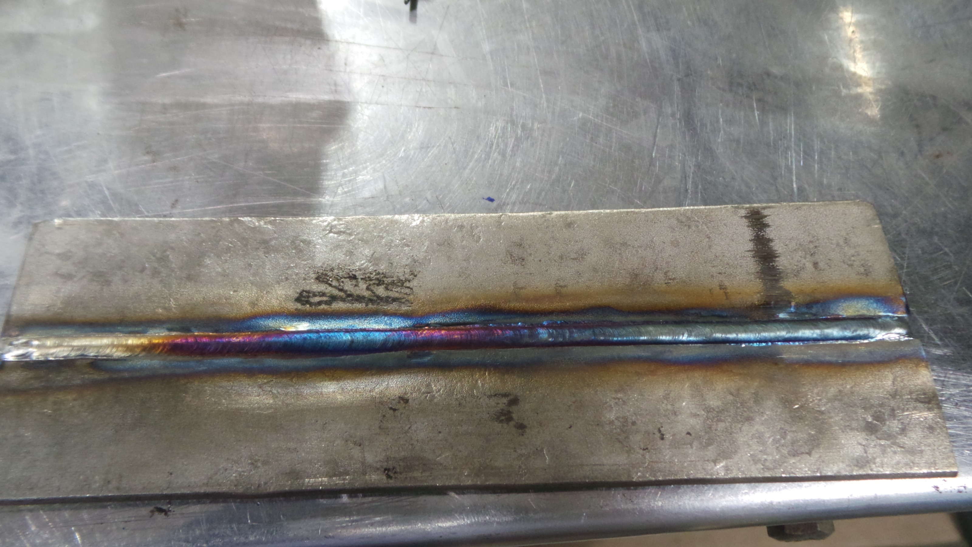

Hello all !
I have managed to put together a single axis TIG welding CNC machine for seam welding using Arduino & GRBL, using a GUI to send G code to the Arduino . The only hiccup is that the USB connection between the Arduino & the Laptop sometimes freezes when initiating the arc by HF initiation. When that happens , the g code that follows does not get executed, & the rest of the commands ( such as turning off the arc etc) have to be manually dealt with.

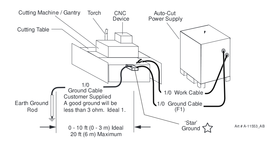

I have also done a project with Inox Tig welding on CNC. The problem is indeed the HF ignition start of the Tig welding inverter.
Also HF plasma inverters have the same problem and are not usable for CNC. Only the expensive plama machine's with HF start are
good insulated to work with CNC. Then we talk about branches Hypertherm or Thermal Dynamics.
To reduce the problem you can try :
1. Make a good ground connection => machine to earth cable and ground
2. Use a opto isolated break out board.
3. Use mosfet relais (torch start) in stead of mechanical click relais.
4. Isolate your cnc hardware into a metal box
5. Use a differtent power connection for your tig inverter.
6. If your computer screen is flickering you know it's not good.
7. My experence is that after a time (can be a few weeks) your computer i/o can be broken.
SSP :
Have luck !!

Replied by tommylight on topic CNC Tig welding
HF interference is a pain to deal with, but with some attention to details can be awoided always.
Proper grounding is the main part of the equasion, plasma cutter must have proper grounding, cables for torch ignition must be shielded and that shield connected only on the electronics side. All other cables and electronic must be as far as posible from the plasma, all power supplyes must be grounded to the mains ground.
Do not connect ground wires from plasma to electronics. Never.
Awoid daisy chaining ground wires, all should be on a single spot.
You should also use better usb cable, cheap ones have no shielding and some have straight data wites, they should be twisted inside.

- SSP
- Posts: 2
05 Jan 2018 06:16 #104043
by SSP
Replied by SSP on topic CNC Tig welding
