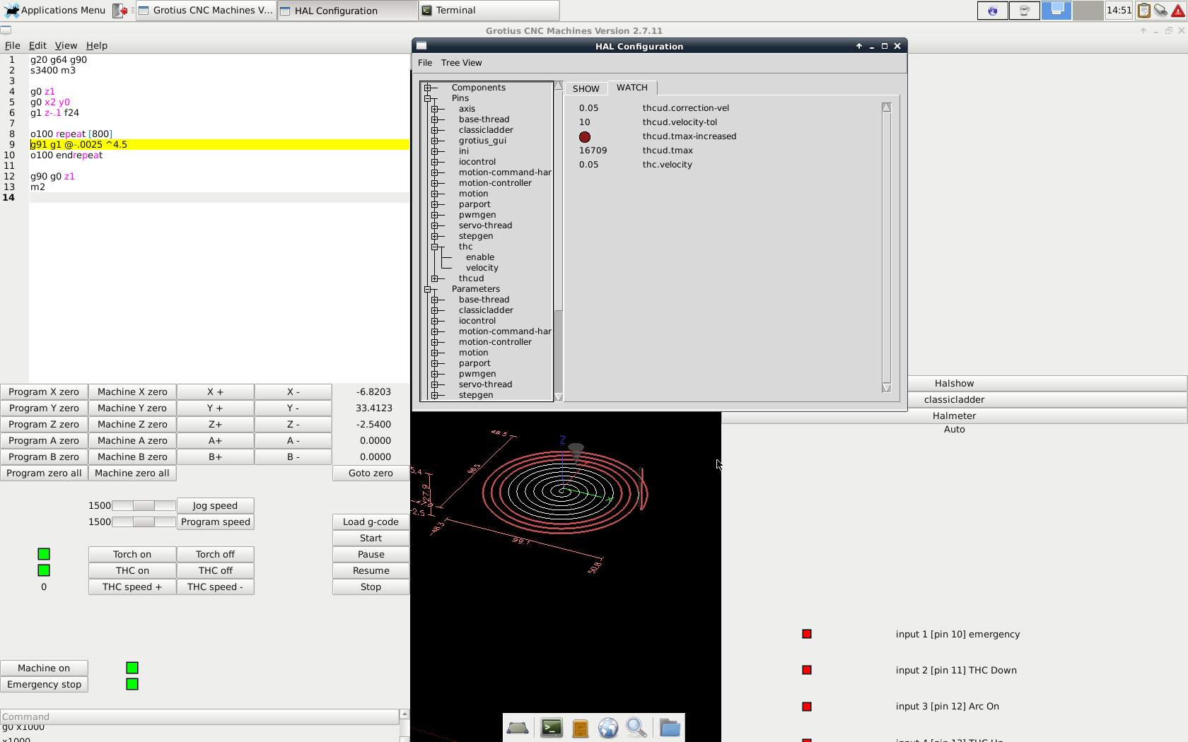

Hi Nerd here again,
I have big problem.
This is working good, i can turn the thc on and of via glade panel button :
Now this is problem :
What ever i do, it is not working. The message is mostly, thcud.velocity-tol does not exist's...
Both pin's are available in halmeter in section pins
Orginal the example is setp, this works good, but is not handy in practice way's :
Please help me.
I have big problem.
#THC enable
net systemlink0 thc.enable thcud.enable grotius_gui.hal_led_thc_onNow this is problem :
#THC value
net systemlink1 thcud.velocity-tol thc.velocityWhat ever i do, it is not working. The message is mostly, thcud.velocity-tol does not exist's...
setp thcud.velocity-tol 0.05Please help me.

Replied by PCW on topic problem with thcud.velocity-tol
looks like thcud.velocity-tol is a parameter rather than a pin so can only be setp'ed
If changing this "live" doesn't cause any issues the easiest fix would be to change it to a pin

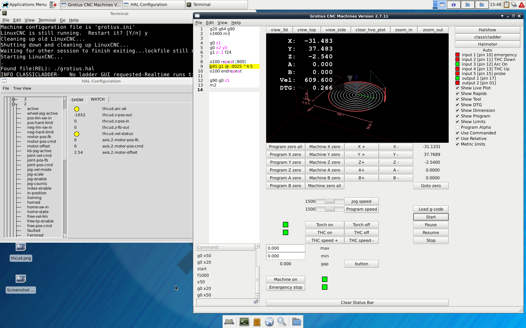

Thank you for the comment. I have tried to fix it to make the connection as a pin output and also as a variable output.
I see it the value's are available in halmeter, but the connection can not be made in the hal file section.
Maybe i must try to connect them with python script.
Now i was looking at the thc when the program is working. The z-axis motor is responding normally on the thc up and down input signal. So this go's well. But the Z-axis dro on the screen is not changing when the TCH is enabled.
It looks like the correction value of the THCUD is not linked to the actual z position.
When the THC is disabeld, the Z-axis dro value is oke en normal responding.
thcud.z.pos-out value is about -1600 at the screenpicture. This value should be on the z axis dro displayed.
See also the picture of the z axis output value's
This is my hal section, i looked a long time to look what is wrong, i have cleaned it up :
Is it possible for me to experiment with the THCUD.comp file? Is it only possible to make a comp file with halcomp in terminal?
Or is it possible to change some code directly in the THCUD file? This is new for me, but maybe good to practice.
setp stepgen.2.position-scale [AXIS_2]SCALE
setp stepgen.2.steplen 1
setp stepgen.2.stepspace 0
setp stepgen.2.dirhold 35000
setp stepgen.2.dirsetup 35000
setp stepgen.2.maxaccel [AXIS_2]STEPGEN_MAXACCEL
net zpos-cmd thcud.z-pos-in => axis.2.motor-pos-cmd
net thc-pos-out thcud.z-pos-out => stepgen.2.position-cmd
net thc-pos-fb axis.2.motor-pos-fb <= thcud.z-fb-out
net zstep <= stepgen.2.step
net zdir <= stepgen.2.dir
net zenable axis.2.amp-enable-out => stepgen.2.enable
net requested-vel thcud.requested-vel <= motion.requested-vel
net current-vel thcud.current-vel <= motion.current-velIs it possible for me to experiment with the THCUD.comp file? Is it only possible to make a comp file with halcomp in terminal?
