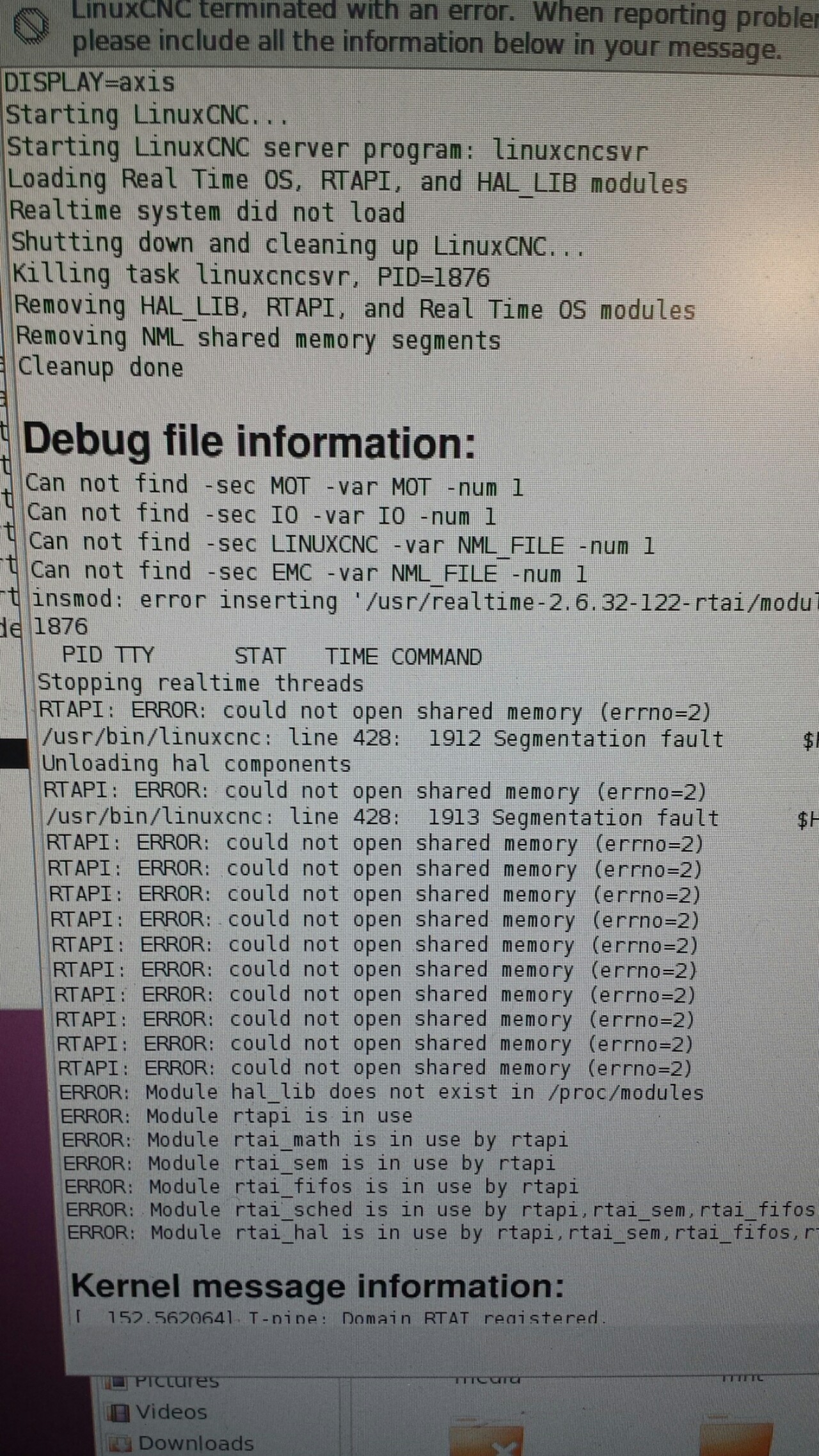

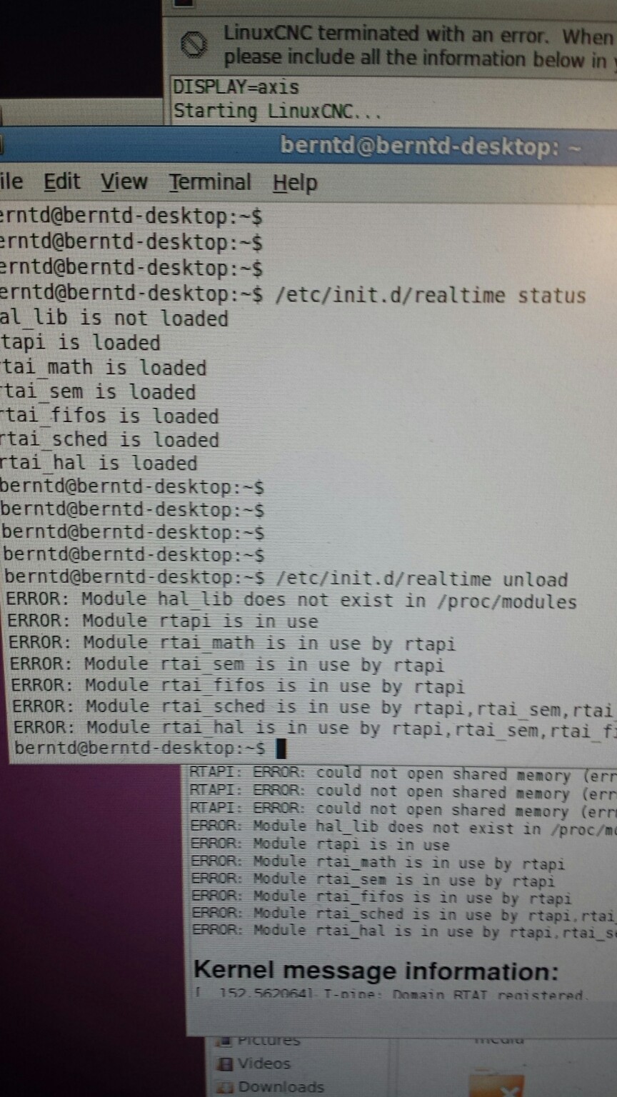

Oh man, I am sitting with a half finished machine job...
I loaded a file with an error in a while loop.
Linux cnc went busy forever and so did the computer until I turned it off.
After restart, linux cnc will no longer start.
The computer was set up in 2012 and has no network.
Hence the pictures.
What can I do to get it working again?
Regards
Bernt

It seems the hal_lib is missing in /modules...
If so, where can I find it and copy it back in?

I'd run fsck ..... Could be a file system issue, if the computer wasn't shutdown properly.

Far out, it works again.
I have no idea what it was. I did run fsck but not sure if that was it.
Anyway, I am machining again.
