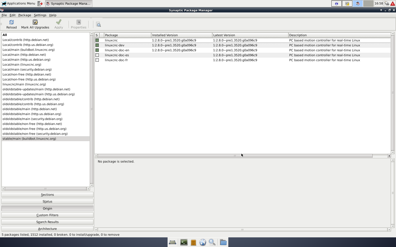

14 Jan 2018 22:07 - 14 Jan 2018 22:11 #104474
by Grotius
Replied by Grotius on topic Linuxcnc motion backwards (adaptive-feed negative value) and nothing happens
@Pcw,
No, not that way. I have no experience with that way off installation. For me it's all new, so it's sometimes very difficult to
understand how things are working with Linux.
I did a clean cd installation, after that i deleted only the linuxcnc installation with the package manager. I think 2 or 3 package deleted.
And after that i installed then a newer version, see picture.
Also important to have a fresh install when you are mostly of time digging in the root section to see how things are working.
But things go pretty good at this moment. I learned a lot in the past weeks.
I think i see a few little bug's in gmocappy. The "all home" button does not work.
Also i see when you do a mdi command, you can only stop the machine with emergency button, this is not the way to manage
a mdi command i think, I preffer to have a pause and stop button when you are in mdi mode.
But the Gmocappy has a powerfull python code. It is really made by Linux experts.
