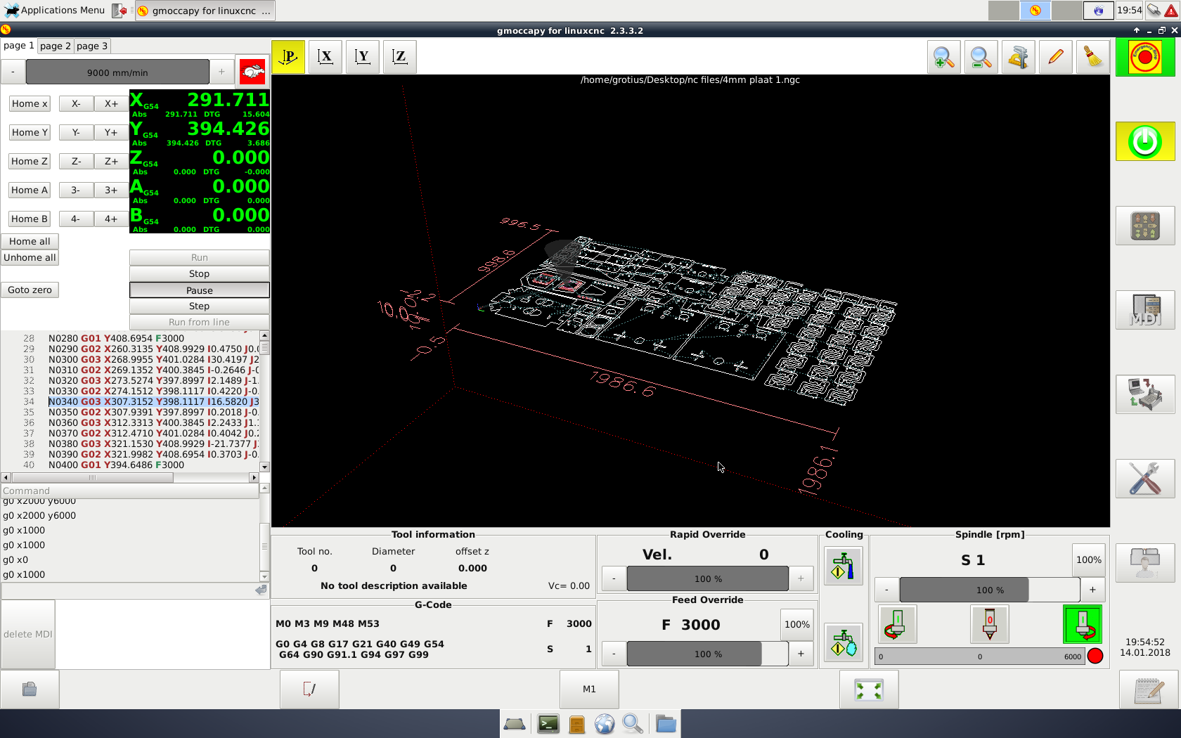

@Hi Rodw,
How are you? Thank you for your comment's on the other topic.
Gmocappy has a powerfull code. Very good !! I am lucky that yesterday i had made a upgrade.
I am trying out bit by bit to change the screen to my desires. It takes a while, but in the end it will be practical for plasma.
Homing sequence is now done by one click for all axis.
Running the program is also one click.
Fixed axis position's without auto generating 4 and 5, and up to 9 (deactivated some line's off code).
This week i want to integrate the negative adaptive speed. This will take a while. I hope this is possible with this Linux version.
I think easyest is to make a button for negative speed command.
After that i want to integrate the THCud function for the torch height controller. This function works fine.

Hi Rodw,
I implemented the adaptive-feed option in Gmocappy. It's not working negative on the version 1:2.8.0 pre. Pcw know's this also i think. The function is working only on value's 0.0 to 1 for full adaptive speed combined with the Macro code M52 P1. The only float in command left is analog in. But this is unusable for negative feed. Also a negative g-code value gives error on the g-code intepreter.
I have not looked in the intepreter source code. Maybe here is possibility.
Tricking the system is not possible also if you use a negative feedrate.
The most quick way is to change a few lines of code in the command.c file and a few other files. The log's for how to do this lives on github. It's not very difficult. Just copy past... en delete some lines of code.
But i can not find this "command.c" file on my system. I only see this file in the github download's. But on my system i don't know where it's located. Also i have no file search function in Thunar. Maybe someone know's how to.... Maybe the file is gone after compiling linux on your system?

- Posts: 18105
- Thank you received: 5328
15 Jan 2018 19:09 #104507
Replied by PCW on topic Linuxcnc motion backwards (adaptive-feed negative value) and nothing happens
Reverse feed rate override is only implemented non-merged branch so currently you must fetch the reverse
feed branch you need (with git) and build it from source.
