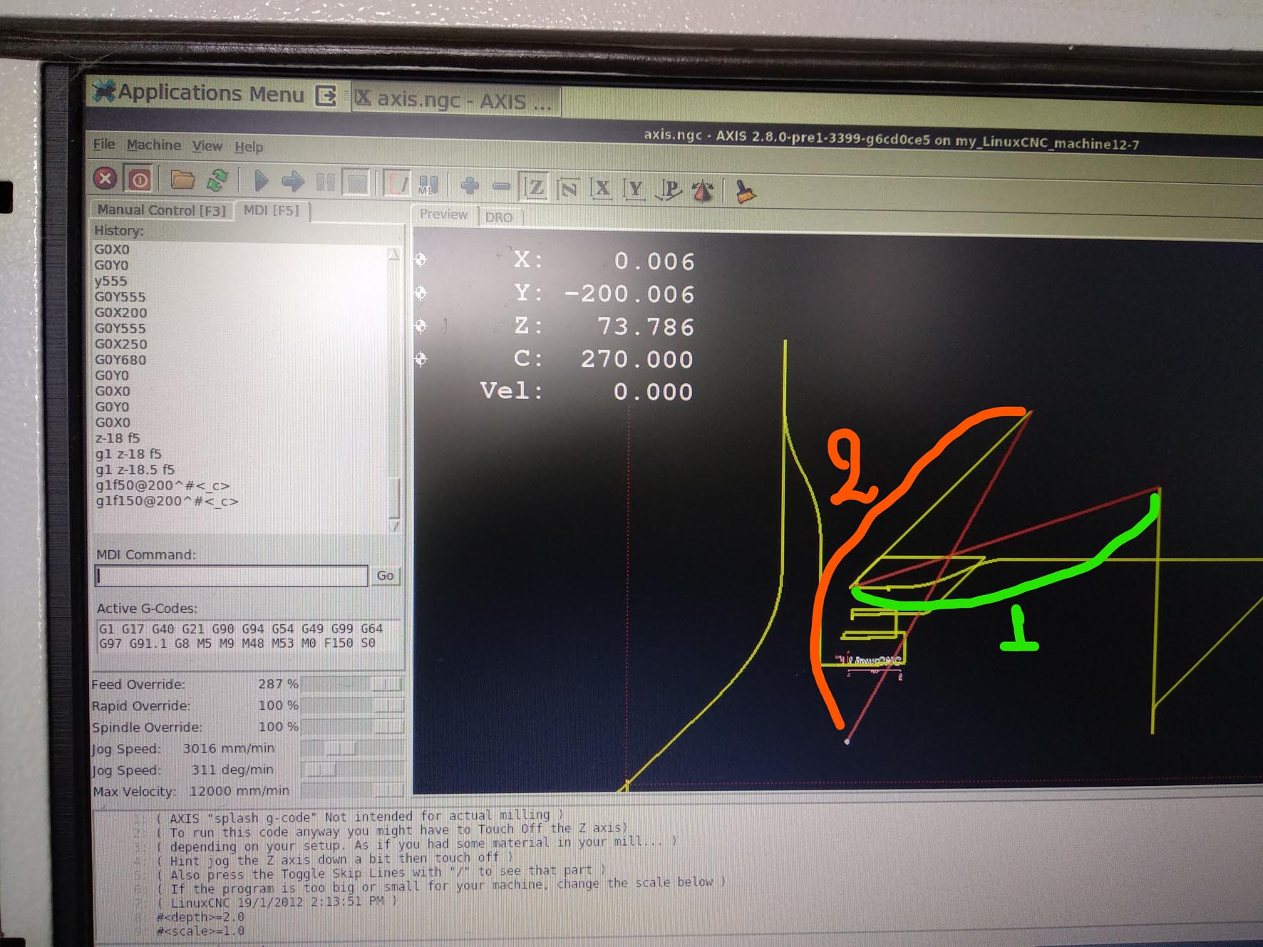

You have to bear in mind that the centre of the polar coordinates is the current X=0 Y=0 position.
So, after jogging to position and aligning the saw you need to either use the "touch off" button to zero X and Y or use G10 L20 X0 Y0
Replied by andypugh on topic CNC BRIDGE SAW FOR MARBLE
i follow your instructions in the mdi command
please check the photo is ti ok what you see?

24 Feb 2018 07:44 #106425
by Yannis
Replied by Yannis on topic CNC BRIDGE SAW FOR MARBLE
Hi
since i want to create physical buttons the best approach is to create a MDI_COMMAND with a multi line code
here is the moves needed
FIRST MDI
1)Z-50 F50
2)zero the x y(to start the polal coordinates)
3) G1 F100 @2000 ^#<_c>
4)G0 Z50
i don't now if the second line must be first
SECOND MDI
1) stop all the moves
2) G0 Z50
suggestions?

MDI commands can only be single lines. But there is a simple work around, put the commands in a subprogram and call the sub with the MDI command.
For your 2nd line I think I would use a G92 X0 Y0.
You might find it advantageous to have a G92.2 to cancel the G92 at the end of the sub.
