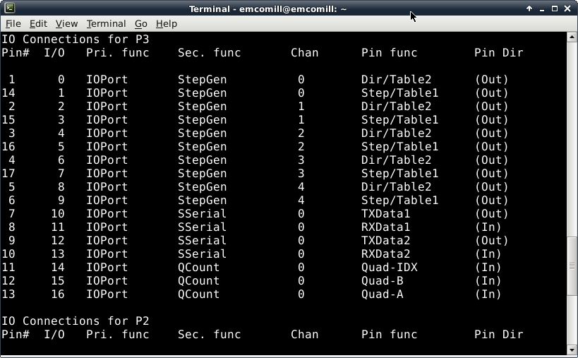

Hey everyone again, my machine is working great but i have a ghetto switch to enable the driver.
i saw this video
and tried to do the same thing which is plugging the drive enable wire which is just 5v into DIR3+ A-AXIS
but i don’t get any power out of that pin.
has anyone done something similar?
thanks

You can use the 4th axis step/dir signal as 5V enable signals if you like, you need to:
1. Enable only 3 stepgens (this frees the GPIO pins that drive the step3/dir3 pins (plus the stepgen 4 and 5 pins))
2. Find the GPIO pins that match the stepgen3 step/dir signals
sudo mesaflash --device 5i25 --readhmid
can help here
3. Set the GPIO pins into output mode ( set the is_output attribute for the stepgen3 GPIO pins )
man hostmot2 can help here
4. Chose the output pin (from the stepgen + or - pins) that disables the drive at startup
can help here

Did you run Mesaflash to see what GPIO pins connect to the stepgen 3 pins on the 7I76?
Did you look at the hostmot2 manual in the GPIO section?

18 Jan 2018 17:09 #104676
by zmcdona1
Replied by zmcdona1 on topic 5v drive enable on mesa board
im at work right now, ill give it a go when i get free.

You use the I/O number not the connector pin number so the GPIO pins associated with stepgen 3 are GPIO6 and GPIO7
once you disable stepgens above 2 you need to set GPIO6 (and or) GPIO7 to output mode (they are inputs if not set into output mode) and then you manipulate the output state by linking the GPIO output pin to the proper signal in your hal file
